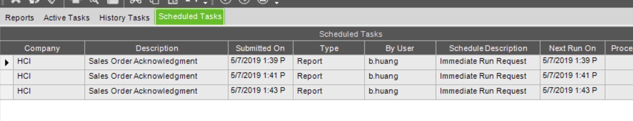

Tried to print order acknowledgements (a report). But it went to Scheduled Tasks not Active Tasks, shown in System Monitor. Anyone knows why and please help. Thanks.

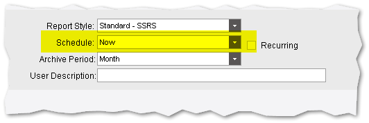

Check the Schedule selected on the reports print window
If all reports are just queing up in the Sys Monitor, the task Agent has probably stopped.
Thank you Calvin. The Schedule was Now. Below is a snapshot.
