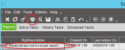

Where is the time being spent for printing? if you check the System Monitor, on the Active Tasks tab, the actual printout will not be sent to the printer until after it finishes running the report in the Active Tasks. with the info given so far, we dont know if the extra time is in generating the report, or spooling it.
Also… if you look at the reports tab, it is possible to select a pre-generated report and re-print it… you might try that to see how long that takes:
Just quickly looking at the System Monitor on History, as we have no active tasks right now, it shows only about a minute per print at the longest. Also, right after I called and posted this, everything seem to go back to normal. Never had the issue of normal then slow, then normal, etc like today has been.
