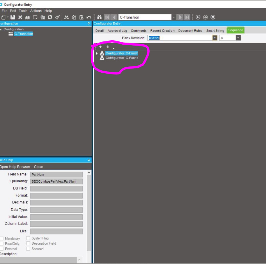

What table holds the configurator sequence for a part revision?
Does anyone know what table in the database the configurator sequence is stored?
See the picture below for a part and its sequence. Looking for the table where this is held. We are doing DMTs and we just want to double check that all updated methods generated a configurator sequence after approving the rev. @timshuwy … any ideas?
I think it is PCStruct
Sorry, but i am not actually sure… but the thing is, you cannot import the configurator until after the Part Rev/BOM is imported, so the question may not be totally applicable. If you import the configurator first, it will not be connected to the part.
We are DMTing methods for parts that contain subconfigurators. When we finish the DMT and approve the methods we notice that sometimes the sequence for the subconfigurators does not get generated… That is why we were looking to see if there was a table that holds the sequence so we could query it and find out if it generated for the methods we approved… Not sure if I am explaining it well enough. But in any case, PCstruct is what we were after. Thanks @timshuwy
