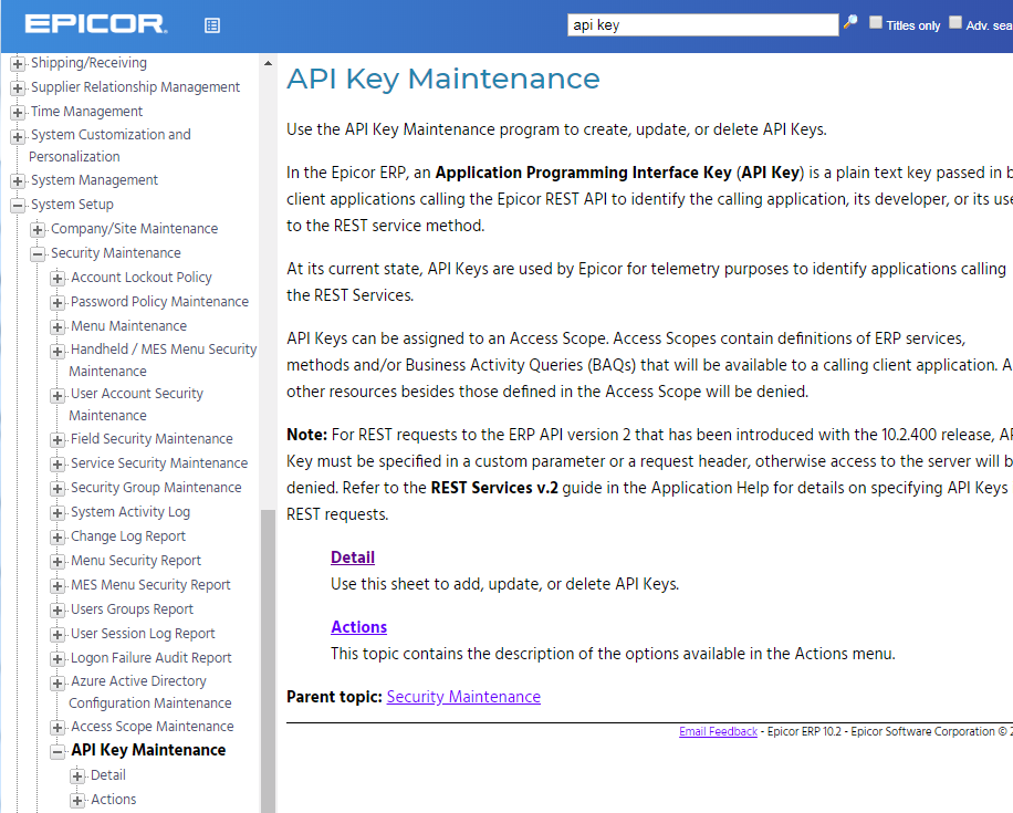

If you visit the Application Help via Help -> Application Help and you are in version 10.2.400+ there is an API Key section.
I think the Maintain API-Keys function is within the application. Search your menu space for API.
