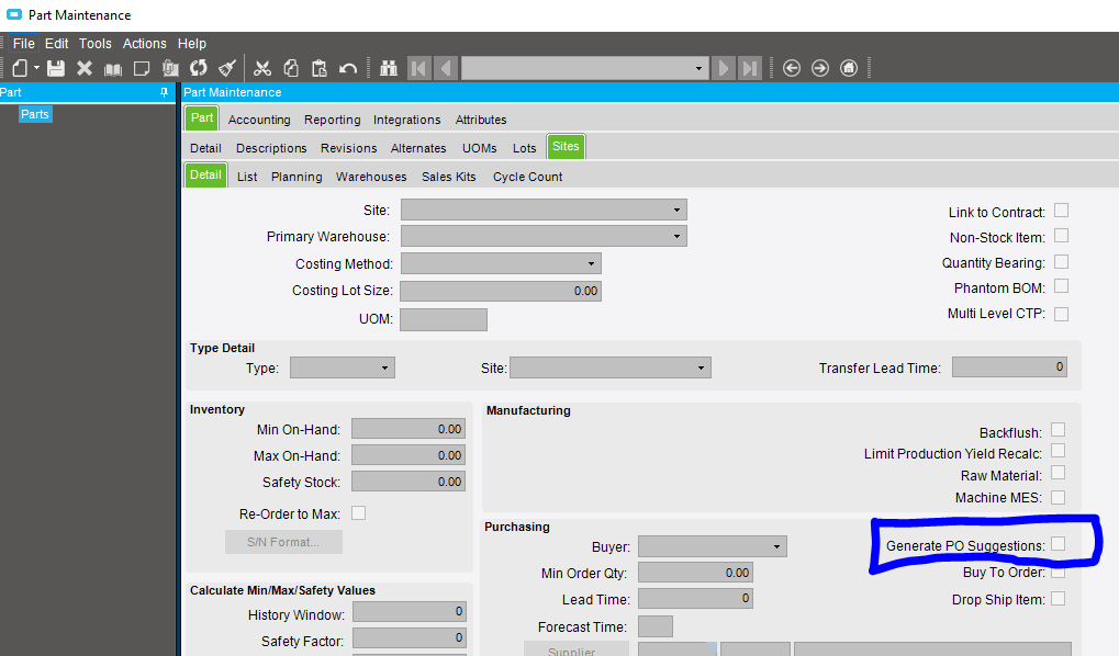

Try checking the part master setup.
generate po suggestion not selected.
@prash172,
all parts that were not generated like suggestions have Generated PO Suggestions checked.

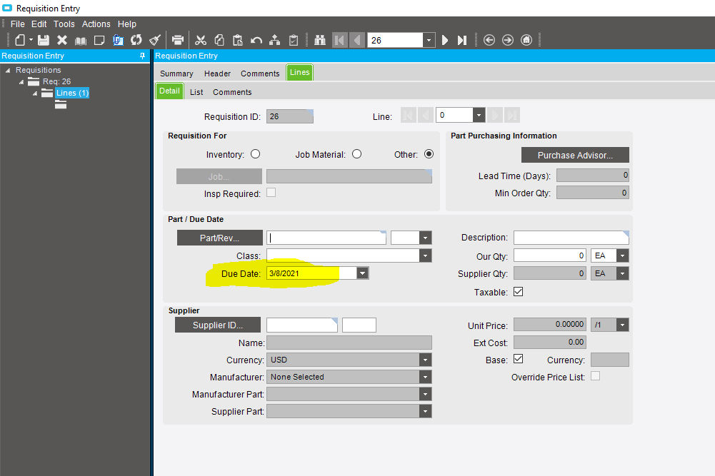

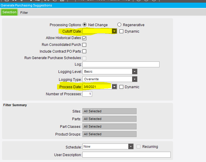

Can you check the “Due Date” on the requisition? Then Check the “Cutoff Date” and "Process Date on Generate Suggestions.
Ran into some issues recently where this was the culprit. If you leave the dates blank on Generate Suggestions, it defaults to System current date.
Also, confirm that the items are not showing up as change suggestions.
Hi @Fernando,
I tried your solution but I does not show the PO Suggestion.

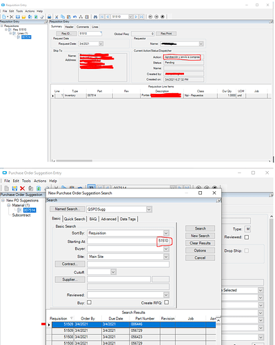

The following image shows the Requisition Ready to be purchased, in theory it should show in New PO Suggestion.
After run the Generate Suggestion like you described, I couldn’t see the Requisition.
Does it need to be approved? I noticed the status said pending on your screenshot.
No, this requisition already was approved and it is pending to purchase.
