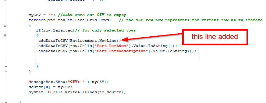

So. I got the button working. SUPER excited. There are a couple of changes needed.
First, the headers are in the file. In the private void PrintClick(object sender, EventArgs e)
section, we need to call the header to be sent somewhere right?
Secondly, there needs to be a carriage return after the lines. The text file has all one line. I’m thinking, after the addDataToCSV line of the code below, there should be something to add the carriage return right?
myCSV = ""; //make sure our CSV is empty
foreach(var row in LabelGrid.Rows) //.the var row now represents the current row as we iterate
if(row.Selected)// for only selected rows
addDataToCSV(row.Cells["Part_PartNum"].Value.ToString());
addDataToCSV(row.Cells["Part_PartDescription"].Value.ToString());
Other than those 2 little things it works great. I’m super excited to get this working.
So I did some googling and tried adding this code
It puts quotes around the carriage return (big surprise right.)
I’ve been trying to find out how to get the header data to write first, but no luck yet.

Maybe the easiest way is to do:
private void addDataToCSV(string datastring)
myCSV += datastring;
What do we need to do with the headers? Do you need them or no? I apparently had a lapse of consciousness when I added MakeLabelData because we aren’t even using it.
The easiest way to ADD headers:
addDataToCSV("\"PartNumber\","); //ADDED
addDataToCSV("\"Description\""); //ADDED
addDataToCSV(Environment.NewLine);
addDataToCSV("\""+row.Cells["Part_PartNum"].Value.ToString()+"\",");
addDataToCSV("\"pn\","); //add the header information here. This can be done in one line or in many like is shown
addDataToCSV("\"desc\"");
addDataToCSV(Environment.NewLine);//this adds a carriage return to add this to the next line
addDataToCSV("\""+row.Cells["Part_PartNum"].Value.ToString()+"\","); //this adds the data with a comma after it. The comma is needed for each record except the last on a line
addDataToCSV("\""+row.Cells["Part_PartDescription"].Value.ToString()+"\""); //this is the last record on the line. It doesn't need a comma becuase there will be a carriage return before the next line
MessageBox.Show("CSV: " + myCSV);
source[0] = myCSV;
System.IO.File.WriteAllLines(to,source);
myCSV += datastring ;
