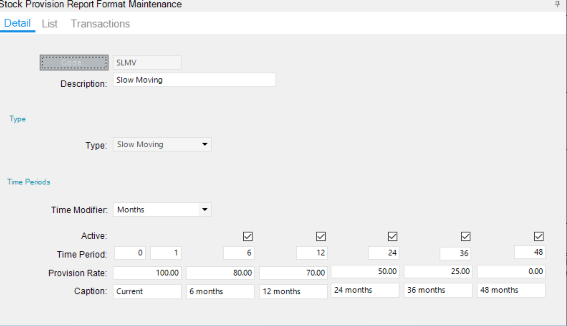

You might want to check out Slow moving inventory and excess inventory reports in Inventory management.
Make sure to first setup Stock Provisioning for the reports.
This way you leave the cost as is, but if there hasn’t been any movement for a while, the report will reflect your suggested value.

Setting Up Stock Provision Reports
Article last updated: Yesterday at 20:00
You are an inventory manager. At the end of the year you need to calculate stock provision for excess inventory, slow moving inventory, and inventory that passed its due date and can no longer be sold at a regular price. In Kinetic you have the following reports that can help you: Excess Stock Provision Report, Slow Moving Stock Provision Report, and Obsolete Stock Report. However, before you run any of them, you need to define its settings. Do it in Stock Provision Report Format Maintenance.
