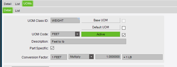

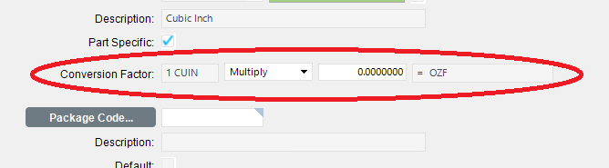

Two other things you may want to look at… first, in the UOM Class program on the UOMs > Detail sheet, make sure the Conversion Factor is set to “Multiply” and “0”:

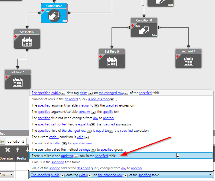

Second, have you tried a Data Directive on the PartUOM table?

Thanks for the suggestion. I tried to start with updating the conversion factor on the UOM Class program, but the ones we use frequently are now stuck in read only. I guess I know now to set this when setting up a new one, but I think I
am stuck on the old ones – unless I create a whole set of new conversions. I’ll try to see if support can help me data fix the key ones, but I doubt they will help.
I have also thought of the Data Directive, but I need a way to distinguish between PartUOM’s that have just been created, and ones that have just been updated by a user. Any ideas on how I can tackle that?
Using and in-transactions data directive, you make a condition, and one of them you can set for if there is an added row in the table.
What @banderson said…
Thanks guys for all your help. Ernie’s suggestion triggered something for me. I can’t edit those fields on the UOMClass program, but I just tested DMT and it lets me set them to 0. I’m going to try the DMT route and if that works, I won’t
need a BPM.
