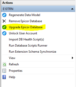

Restore the database and apply upgrade process in admin console

I followed the upgrade Epicor Database using the Admin console, and all went well. Oddly it didn’t ask me to re-run anything in the Conversion Workbench (it didn’t launch). I went into the client and opened the Conversion Workbench and nothing was pending.
