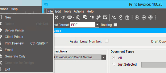

An alternative, perhaps, easier to sell workaround to users is that they can click File > Print Preview or File > Client Printer instead of clicking the buttons on the toolbar.
Setting up the hot key would be my preferred solution. Just don’t press the keys too hard :wink:
