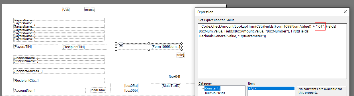

I was in the same boat so I just spun up a newer version of Epicor on a test vm and snagged the latest RDL. One of the things I found was a typo in the Amount box expression. There is a + “.01” that is supposed to be + “.1”.

Yes all 3 are printing to the sheet and relatively lined up. I downloaded and installed 10.2.600.35 on a test VM and was able to grab Epicor’s RDL from the reports folder. I uploaded it to our environment and fixed the typo mentioned above and now we are good to go.

Regarding this typo though:
Whatever is going on there is different in different versions. Mine works without changing that formula (and actually breaks if I do change it to .1). I’m working in v10.2.700.4 and swapped in the RDL file for version 10.2.700.30

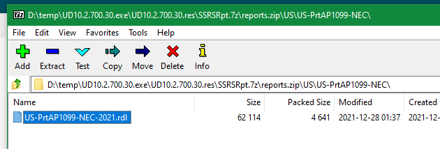

I don’t have any version of Epicor 10.2.700 (we’re on Epicor 10.2.400) and I needed this in like 2 hours or less today, so installing a version of Epicor 10.2.700 somewhere and patching to the latest 10.2.700 patch was not an option. So I downloaded the 10.2.700.30.exe patch/update from EpicWeb and was able to use free, portable 7-zip to extract the RDL file I needed. You just open up 7zip, browse to the 10.2.700.30.exe, right-click :arrow_right: 7-zip :arrow_right: Open archive. Then was able to navigate down into nested 7zip/zip files down this path to find what I was looking for:
…\UD10.2.700.30.exe\UD10.2.700.30.res\SSRSRpt.7z\reports.zip\US\US-PrtAP1099-NEC\

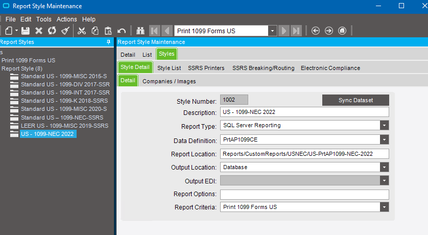

Was able to install this in our 10.2.400.40 patched virtual lab environment (our production Epicor 10.2.400.19 environment doesn’t even have the concept of 1099-NEC in it), and it printed out great first try! Thanks for the great info.

(Note the RDL name change to US-PrtAP1099-NEC-2022 is because I made a new copy / style for this year, because needed to move things around on the form slightly again)
