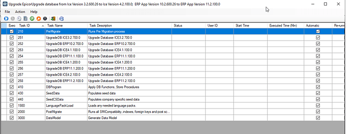

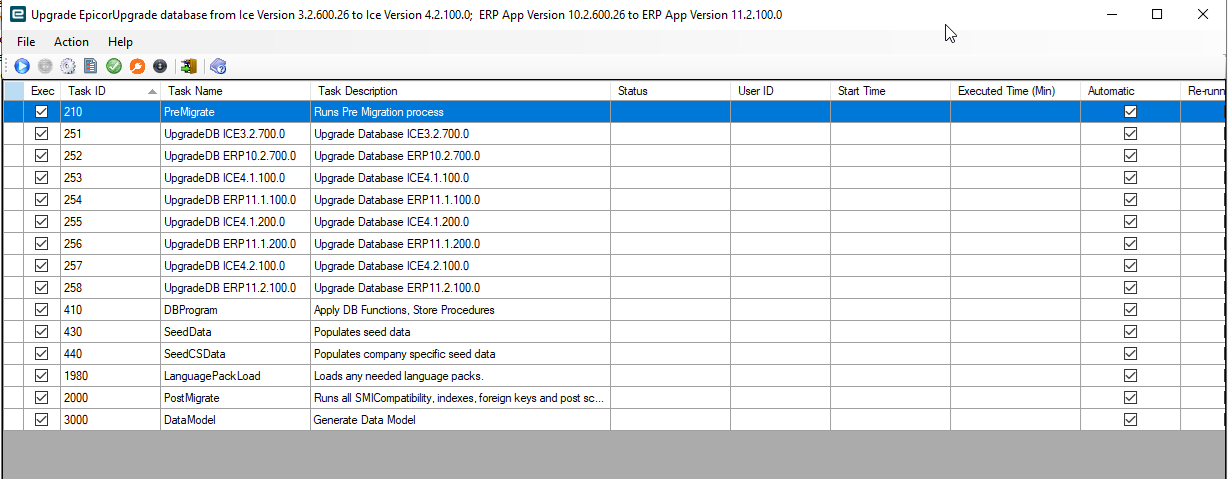

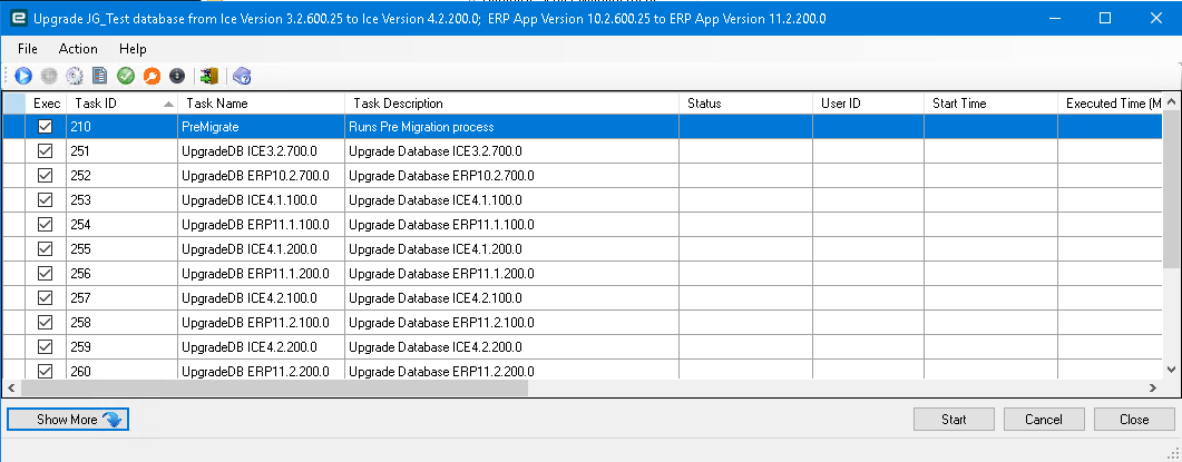

After a bit of messing around getting a 10.2.600 DB up. On upgrading to 11.2.200, I noticed that my version of the DB upgrader has a few more steps in it. Is your 11.2.200 Database Manager Extensions install corrupt? Here’s a screenshot of mine.

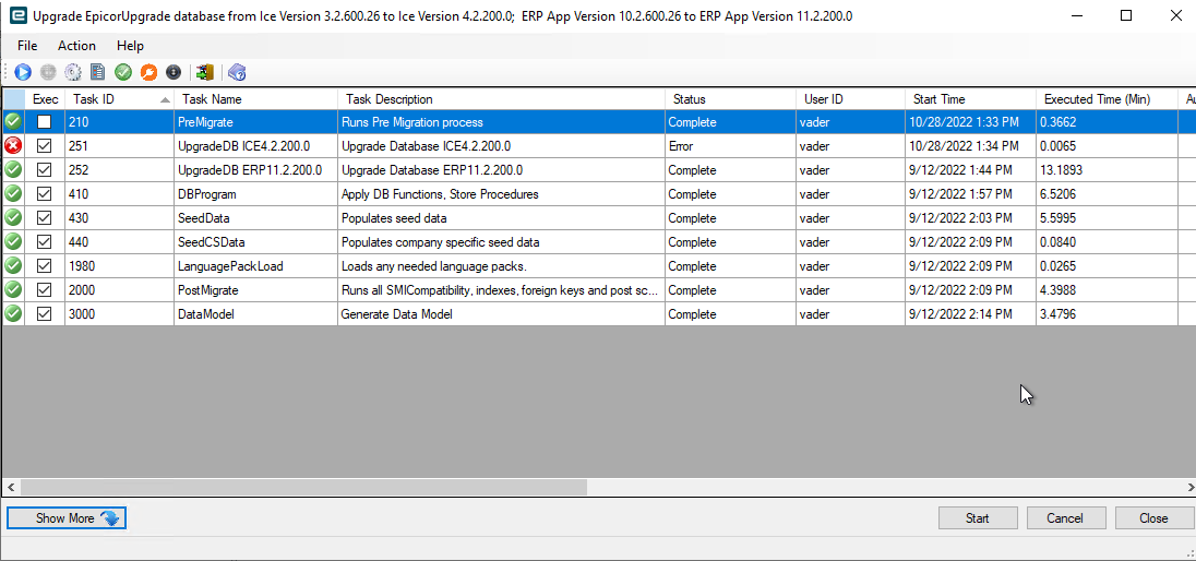

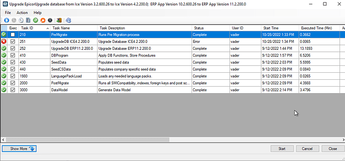

Anyone experiencing this, the best guess, is that there is an existing __MigrationTasks.xml template for this database that doesn’t include the pre Kinetic 2022.2 steps.
  1. Close the EAC.
  2. Navigate to C:\Program Files (x86)\Common Files\Epicor Software\Database Manager Extensions\4.2.200\DB Migration\MigrationTasks .
  3. Delete all files except the MigrationTaskTemplate.xml file.
  4. Restore a backup of the 10.2.600 db with the same name of the database you were trying to upgrade that wasn’t working.
See what you get. The Migration Tasks files hold the data for the upgrades and they might be corrupted. I’m live on 2022.2 now so this is much harder for me to test.
I have been deleting the SERVER_INSTANCE_MigrationTasks.xml file every time I run this in our upgrade tests because the items were all checked off and I couldn’t do the upgrade. I left the MigrationTaskTemplate.XML file.
