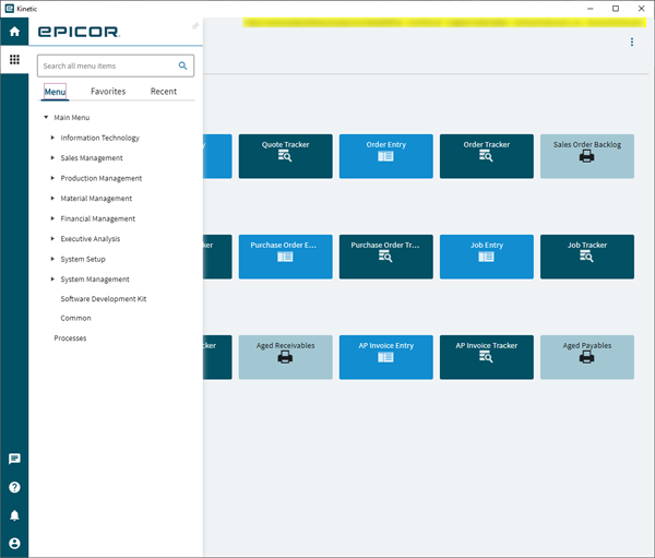

I really need to dive into the whole Kinetic environment a bit more so I know what y’all are meaning when you use phrases like Active Home Page :grin:. I assume that is just the ugly tiled page that starts with the Kinetic client?
I know we are going to want to continue to use the Classic interface for as long as possible to help curb the learning process, just as with you and some of your users.
The little bit that I have played around with Kinetic (non-classic UI) has been discouraging at best for me, so I can only imagine how it is going to be for non-tech people. It scares the bejeezus out of me though, I can say that much.

Yeah, it’s not even called that anymore either lol.
What he is referring to, is in 2024.1, this is the only menu:
