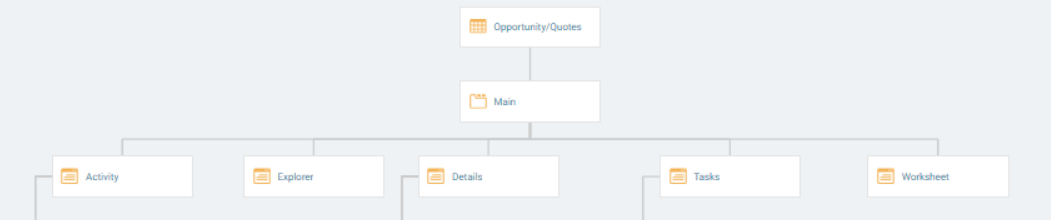

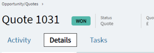

When I now open Quote Entry in App Studio, I see two new tabs: ‘Worksheet’ and ‘Explorer’.
However, in the published version of this layer, these tabs are missing. They’re also not visible if I preview the layer from App Studio.
Has anyone else found that their layers have discrepancies like this? I’ve republished the layer, but still having the same issue.

Yes, that’s right. The tabs have been added to our existing layers but are only visible inside App Studio.

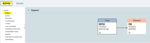

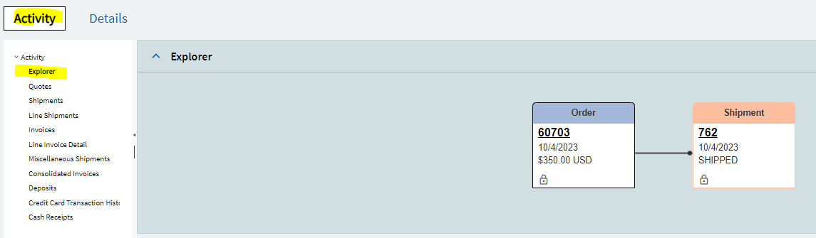

Just fiddling around… I switch the Explorer from a “TabPage” to a “Page” under “Activity”… and now it IS visible and functioning correctly (under the Activity TabPage). So… the functionality is there.
Buuuuut… now I can’t get it to go back to a TabPage under the original “Main” parent, hahaha, oops.

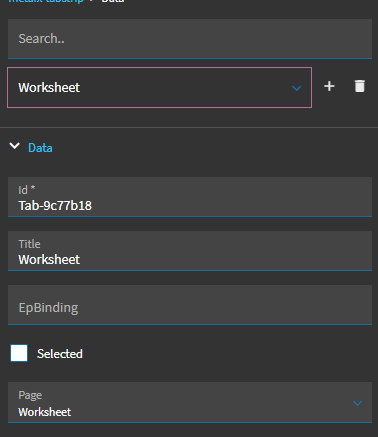

Thankfully, this morning I had a call with Support where they demonstrated a working fix:

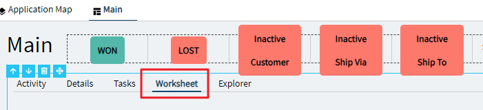

  1. Open the ‘Base Entry’ Quote Entry layer in App Studio.
  2. In the Application Map, select ‘Main’ and then click the Edit Icon
  1. In ‘Main’, click the ‘Worksheet’ tab.
  1. In the right-hand Properties, select ‘Data’.
  2. Then select ‘Worksheet’ from the dropdown.
  3. Make a note of these Property values:
  4. Go to your custom layer. Repeat steps 2-4 above. When you get to Step 5, this time you’ll notice ‘Worksheet’ is missing from the dropdown.
  5. Click the plus icon next to the dropdown to add a new tab item. Enter the same property values from step 6.
And voila, this fixed the issue. Support think something went wrong during the upgrade, which caused this mapping to go missing.

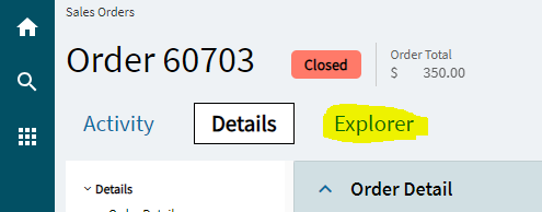

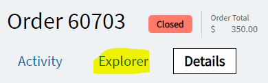

I guess if I wanted to get the order of the tabs corrected (Activity > Explorer > Details), I would have to delete the Details tab and then add it back in after Explorer. Just like columns in a grid, I wish they had a “display order” field where you could easily change them around.
Base Form:
But, to be honest, I can live with “Explorer” being on the end.
Yep, sadly that looks like the only option :smiling_face_with_tear:
