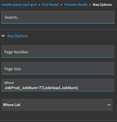

I built a couple grid views while I was at Insights last year. I took a class on Application Studio and duplicated what I learned to one of our existing BAQ’s. The BAQ takes data, which includes some user defined fields, and ties the order releases to a job number. This is a customization we had in classic and I was trying to get it to work in Kinetic. In Kinetic, instead of showing all data from the BAQ, I want to only show the job number that is currently open. I did that with this formula JobProd_JobNum=??{JobHead.JobNum} in the “where” field. This made sure to only show data from the BAQ that was the same Job Number as the current job in JobEntry. Removing the data in the “where” field ends up showing all data in the BAQ, so the BAQ is working properly.

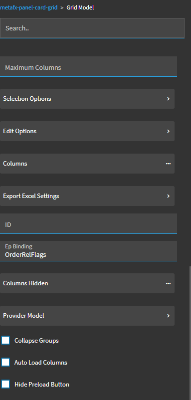

I took screenshots of all of the fields I used when creating the grid.
The BAQ is called OFOrderRelFlags and the View is called OrderRelFlags.
This has been working fine until the latest update. Does this formula from the “where” field no longer work or use a different syntax now?

Try: JobProd_JobNum='{JobHead.JobNum}'

I just tried that, but it didn’t make any difference.
What does the payload look like in the Network tab of Dev Tools when you have it set like that?
What happens if you use the Where List instead?
If you’re using a dataview field, I believe the question marks are required.
JobProd_JobNum='??{JobHead.JobNum}'
That worked! Is there a reason, until now at the 2024.2 update, that it worked without the single quote marks, but now it is required?

JobNum is a string, so you should have the single quotes to denote a string.
