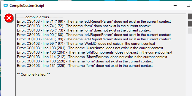

Thank you. I’m getting close. I added the code block for “if (SOPickListForm…” into the private void SOPickListForm_Load(object sender, EventArgs args) method of the customization.
Then, added those two private methods below, but I’m getting a series of errors. Do you have some variables initiated in the beginning of the customization, or did you have to add any other “using” references up there??
Capture
Or, are you able to export the full customization so that I purge what I don’t need?
