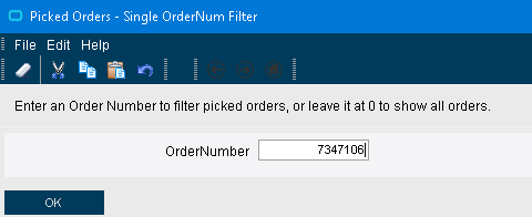

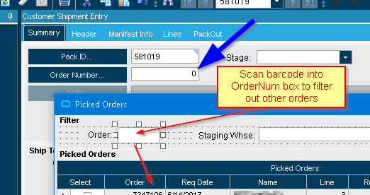

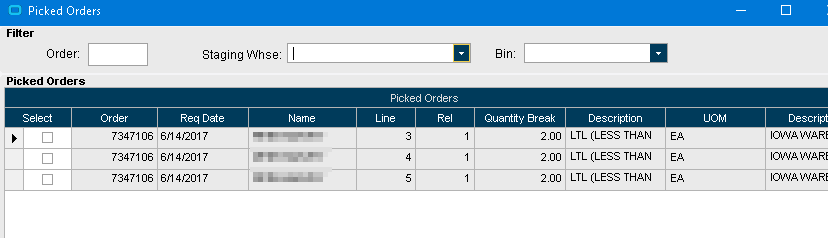

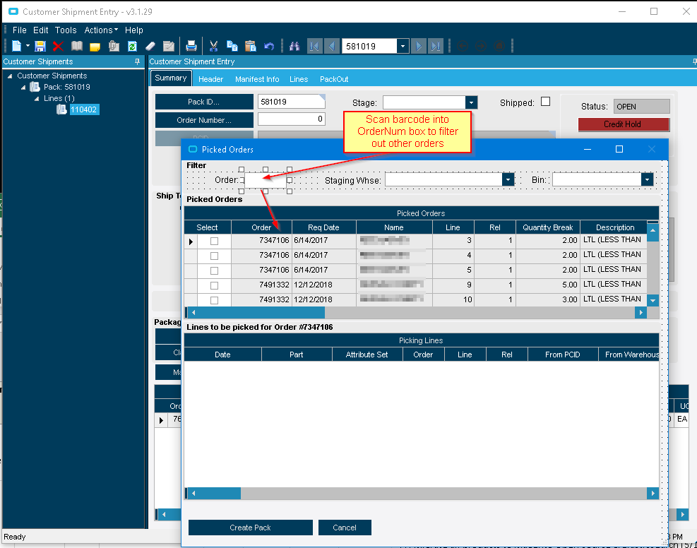

What’s the best way to filter picked orders to a specific order number?
I’ve added an OrderNumber box to the Picked Orders form (Customer Shipment Entry > Actions > F1 Picked Orders), but not sure how to go about filtering out other orders. We’ve added a barcode to the MQR. Our plan was to have the folks in shipping scan this from the MQR into the picked order form (and not have to type it), and just show the related order.

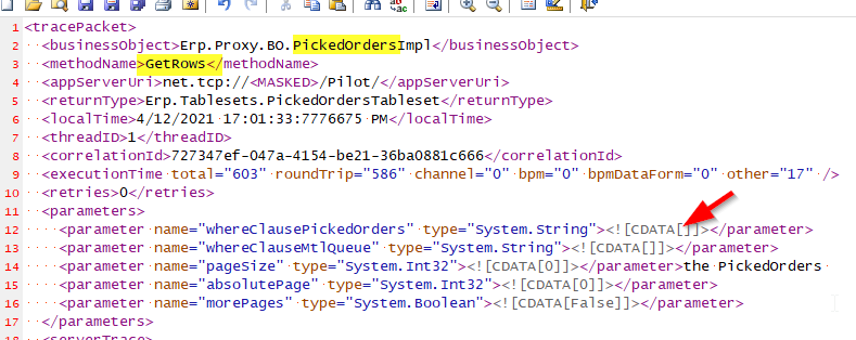

I did a trace, and see the PickedOrders BO calls the GetRows method. Would you filter it out similar to hiding the ShipVia (with the GetList method)? How do you get the order number from the text box on the form a BPM’s variable? Does it need a button, or tab will do it?

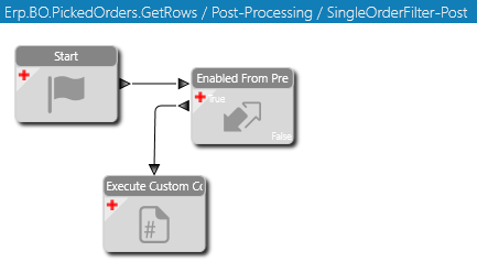

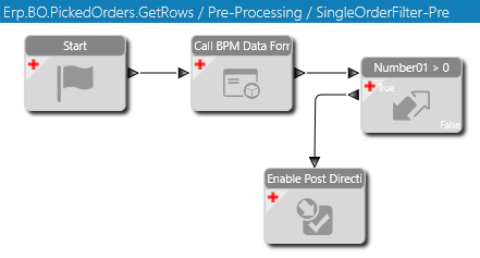

Create a new METHOD BPM in ShipVia GetList as a PRE-PROCESSING BPM
add a new “Set Argument/Variable” widget
change it to say "Set the whereClause argument/variable to the specified Expression
In the specified expression, enter the following line of SQL code (including double and single quotes)
Trace:
<tracePacket>
<businessObject>Erp.Proxy.BO.PickedOrdersImpl</businessObject>
<methodName>GetRows</methodName>
<appServerUri>net.tcp://<MASKED>/Pilot/</appServerUri>
<returnType>Erp.Tablesets.PickedOrdersTableset</returnType>
<localTime>4/12/2021 17:01:33:7776675 PM</localTime>
<threadID>1</threadID>
<correlationId>727347ef-047a-4154-be21-36ba0881c666</correlationId>
<executionTime total="603" roundTrip="586" channel="0" bpm="0" bpmDataForm="0" other="17" />
<retries>0</retries>
<parameters>
<parameter name="whereClausePickedOrders" type="System.String"><![CDATA[]]></parameter>
<parameter name="whereClauseMtlQueue" type="System.String"><![CDATA[]]></parameter>
<parameter name="pageSize" type="System.Int32"><![CDATA[0]]></parameter>the PickedOrders
<parameter name="absolutePage" type="System.Int32"><![CDATA[0]]></parameter>
<parameter name="morePages" type="System.Boolean"><![CDATA[False]]></parameter>
</parameters>
<serverTrace>
<Op Utc="2021-04-12T21:01:33.8802504Z" act="Erp:BO:PickedOrders/PickedOrdersSvcContract/GetRows" correlationId="727347ef-047a-4154-be21-36ba0881c666" dur="562.7036" cli="..." usr="<MASKED>" machine="<MASKED>" pid="1532" tid="178" xmlns="" />
</serverTrace>
</tracePacket>

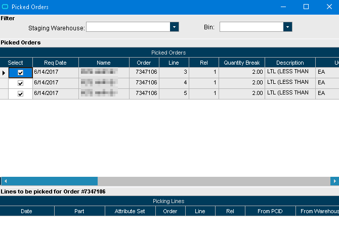

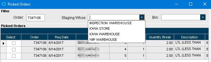

How does the Staging Warehouse and Bin filter work? Trace doesn’t show anything other than a GetList to populate the dropdown, so I’m thinking it filters the already loaded PickedOrdersDataSet in the form. If I could leverage OrderNum the same way, I’d be golden!
I didn’t see anything in the base script editor for the PickedOrdersForm that seems like it filters (shrug). Not sure what to try next…

this.lblOrderNum = new Ice.Lib.Framework.EpiLabel();
this.lblOrderNum_1d2273a1_85b6_4908_97d8_7a9e6b82b67b = this.lblOrderNum;
System.Collections.Hashtable customControls = personalizeCustomizeManager.CustControlMan.CustomControlsHT;
customControls.Add("1d2273a1-85b6-4908-97d8-7a9e6b82b67b", this.lblOrderNum);
System.Collections.Hashtable controlsHT = personalizeCustomizeManager.ControlsHT;
controlsHT.Add("1d2273a1-85b6-4908-97d8-7a9e6b82b67b", this.lblOrderNum);
this.lblOrderNum.Name = "lblOrderNum";
this.lblOrderNum.EpiGuid = "1d2273a1-85b6-4908-97d8-7a9e6b82b67b";
this.txtorderNum = new Ice.Lib.Framework.EpiTextBox();
this.txtorderNum_bba41b31_f206_47a4_b0d5_748223c93fb1 = this.txtorderNum;
customControls.Add("bba41b31-f206-47a4-b0d5-748223c93fb1", this.txtorderNum);
controlsHT.Add("bba41b31-f206-47a4-b0d5-748223c93fb1", this.txtorderNum);
this.txtorderNum.Name = "txtorderNum";
this.txtorderNum.EpiGuid = "bba41b31-f206-47a4-b0d5-748223c93fb1";
// PickedOrdersForm
Ice.Lib.Framework.EpiBaseForm local1 = ((Ice.Lib.Framework.EpiBaseForm)(personalizeCustomizeManager.ControlsHT["76ABF998-638E-430c-B4FE-E7823AA26BCB"]));
local1.Top = 79;
local1.Left = 452;
local1.Width = 705;
local1.Height = 700;
local1.Font = new System.Drawing.Font("Microsoft Sans Serif", 8.25F);
// pickedOrdersPanel1
Ice.Lib.Framework.EpiBasePanel local2 = ((Ice.Lib.Framework.EpiBasePanel)(personalizeCustomizeManager.ControlsHT["f672cdf4-aa32-4edf-ad90-2be9393be666"]));
Ice.Lib.Framework.EpiGroupBox local3 = ((Ice.Lib.Framework.EpiGroupBox)(personalizeCustomizeManager.ControlsHT["9a02ea91-59a8-4bb3-a0fb-930fbb2198ff"]));
local2.Controls.SetChildIndex(local3, 0);
System.Collections.Hashtable nativeSheets = personalizeCustomizeManager.NativeSheetsDCPsHT;
Infragistics.Win.UltraWinDock.DockableControlPane local4 = Ice.Lib.Customization.Designers.EpiCustomSheetDesigner.GetDockableControlPane(local2, "f672cdf4-aa32-4edf-ad90-2be9393be666", nativeSheets);
// grpFilter
local3.Anchor = (System.Windows.Forms.AnchorStyles.Top | System.Windows.Forms.AnchorStyles.Left);
local3.Controls.Add(this.lblOrderNum);
local3.Controls.Add(this.txtorderNum);
local3.Controls.SetChildIndex(this.txtorderNum, 0);
local3.Controls.SetChildIndex(this.lblOrderNum, 1);
Ice.Lib.Framework.EpiCombo local5 = ((Ice.Lib.Framework.EpiCombo)(personalizeCustomizeManager.ControlsHT["d2f0fc0a-8347-4a7d-9231-2f9da479143e"]));
local3.Controls.SetChildIndex(local5, 2);
Ice.Lib.Framework.EpiLabel local6 = ((Ice.Lib.Framework.EpiLabel)(personalizeCustomizeManager.ControlsHT["11ead9c1-7583-4842-a845-7e48a234d258"]));
local3.Controls.SetChildIndex(local6, 3);
Ice.Lib.Framework.EpiCombo local7 = ((Ice.Lib.Framework.EpiCombo)(personalizeCustomizeManager.ControlsHT["a4204b87-f7d3-414a-b774-620886e4cae1"]));
local3.Controls.SetChildIndex(local7, 4);
Ice.Lib.Framework.EpiLabel local8 = ((Ice.Lib.Framework.EpiLabel)(personalizeCustomizeManager.ControlsHT["25cede37-894f-45b2-8de9-af22421aeac8"]));
local3.Controls.SetChildIndex(local8, 5);
// lblOrderNum
this.lblOrderNum.Top = 17;
this.lblOrderNum.Left = 37;
this.lblOrderNum.Width = 46;
this.lblOrderNum.Height = 20;
this.lblOrderNum.Text = "Order:";
// txtorderNum
this.txtorderNum.Top = 17;
this.txtorderNum.Left = 89;
this.txtorderNum.Width = 60;
this.txtorderNum.Height = 23;
this.txtorderNum.Text = "";
this.txtorderNum.EpiLabel = "lblOrderNum";

ckrusen
(Calvin Krusen)
April 13, 2021, 2:37pm
3
I’m not familiar with picked orders, but does the OdreNum field on the Cust Shipment Entry form affect what shows in the Picked Orders pop-up?
askulte
(Andris Skulte)
April 13, 2021, 2:58pm
4
Calvin, it doesn’t seem to. All picked orders are loaded in. There’s also a Picked Orders handheld screen under the DC menu.

My first point attempt would be to try and set the whereClausePickedOrders field in a BPM for PickedOrders.GetRows().
Is any info from the calling form (Customer Shipment Entry) available in PickedOrders.GetRows()? You might be able to build the whereClause based on the CustNum or OrderNum, if either are available.
askulte
(Andris Skulte)
April 13, 2021, 7:31pm
6
Thanks! One step closer. I was able to use @timshuwy’s tip to use a RemoveAll code block in the PickedOrder.GetRows / Post BPM. I hard coded an order number, and it returned all except that one.
ttPickedOrders.RemoveAll(ttPickedOrders_Row => ttPickedOrders_Row.OrderNum != 7347106);
Do I bind the new OrderNumber text box to a new UD Field, or are there placeholders I can use and don’t need to create a UD Field?
How should I push that to the BPM? I assume you set the input somehow to a variable, and then call the variable in the code block instead of hard coding the OrderNum?

-Created a BPM Form for the user to scan in the Order Number
-Method Directive (Pre) PickedOrders.GetRows calls the BPM Form to capture the Order Number, which popups up immediately when the User selects ‘Picked Orders’ from the Actions menu.
-Set the whereClausePickedOrders to this expression:
If ttCallContextBpmData.Number01 = 0 Then “” Else “Company = '” + ttCallContextClient.CurrentCompany + “’ AND Plant = '” + ttCallContextClient.CurrentPlant + "’ AND OrderNum = " + String(ttCallContextBpmData.Number01)

This ended up working really smoothly and the end user experiance is nice:
Select ‘Picked Orders’ from Actions Menu
Scan Sales Order & Click ‘OK’
Picked Lines shown and selected (any unpicked lines for the Order show in Unpicked grid). This step is good for them to confirm the Pack they are about to create and they can uncheck any lines they want to exclude for some reason.
Click ‘Create Pack’
Pack Created!

@ckrusen and @Rick_Bird - Awesome sauce. I’m almost there. Created a BPM Dataform on Pre, asks for the order number (set to CallContextBpmData.Number01) and if >0, then enable post. Post contains the 1 line RemoveAll from @timshuwy , and it filters out the rest of the orders.
Only problem is that the CallContextBpmData.Number01 stays stuck from the last time. I tried to set it back to “” in POST, but haven’t been able to figure out the code how, and the Set Variable widget doesn’t have call context available.
This didn’t work, obviously!

Yes! That worked a treat. Thanks guys.
Here’s the finished product, with baby C# code Clicking 1 row selected all as well.
Pre:
Post:
ttPickedOrders.RemoveAll(ttPickedOrders_Row => ttPickedOrders_Row.OrderNum != callContextBpmData.Number01);
callContextBpmData.Number01 = 0;
