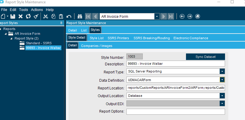

I did the same thing, we needed to add the tracking number. Let me check my settings.
This is my Report Style
