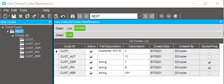

Steve, trying to use your coding method I am trying to add a record into the UDCodes table with a specific CodeType (in this case “NEXT” and a CodeID of “CUST_XXX” where the XXX is defined from the Customer Name. This allows the table to be used to classify a Customer’s ID from a 3 digit identifier - for example IPN and as sequential number taken from the lookup in the UDCodes table from the description field (See “CUST_IPN” record with 6 in the description field. This description field is updated by 1 for the next Customer that is allocated the identifier “IPN”.followed with the number 006 making up a Customer Id of IPN006 with the 006 in the UDCodes “CUST_IPN” record being updated to be 7.
