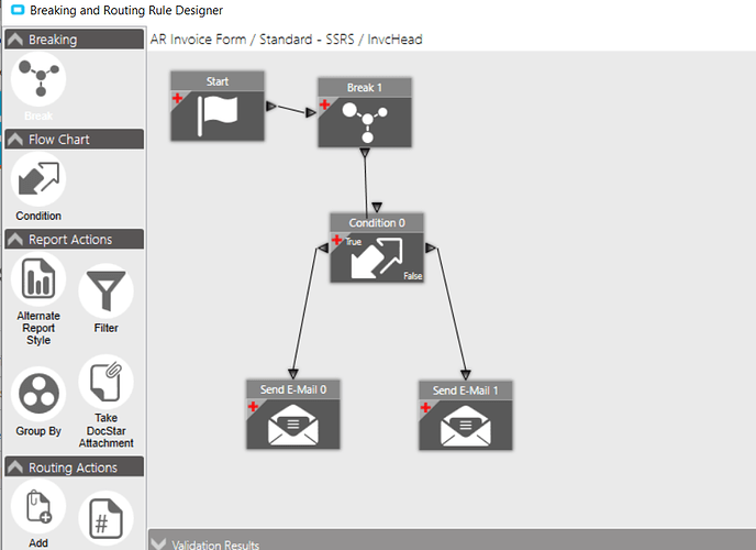

We just enabled auto emailing our AR invoices and it is working but every few groups sent there seems to be an issue with how the report is generating. This seems very inconsistent but there are duplicate lines showing, sometimes up to 10+ times on a single PDF. The totals seem to show correct though. These groups are somewhat on the larger side (100+), but I am unsure this is the cause. Does anyone have any experience with this or know of tweaks we could implement to correct this?
The break is on InvoiceNum, the condition is just to check if the email is blank or not.

Which table is the breaking on?
