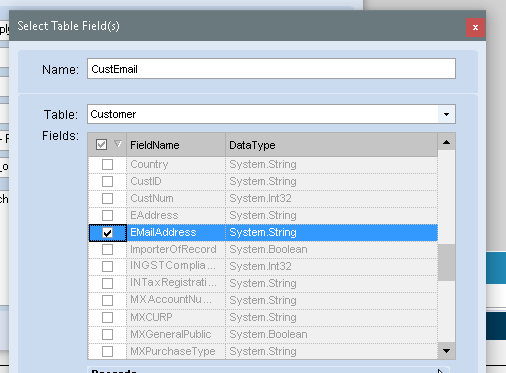

then in the pop up window, select the table and field

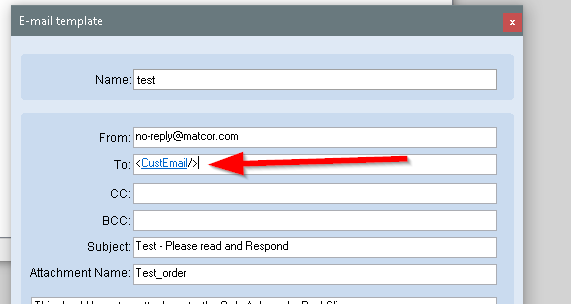

Now each email will use the Customer.EMailAddress field as the email’s TO:

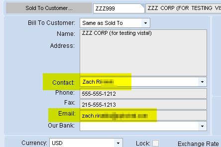

I believe it first checks for a Contact that is selected for Primary Billing
yielding:

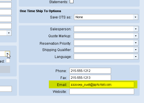

If none exist, then it uses the Customer email from the Customer page
yielding:

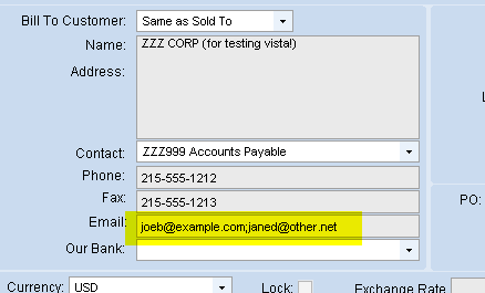

FWIW- You could make a contact for a “group”, and just enter all the emails separated by a semicolon. Like:
yielding:
@ckrusen
oh cool. I didn’t think it would let me save more than one email for a contact. I think i will take that approach. Thanks again for the help
