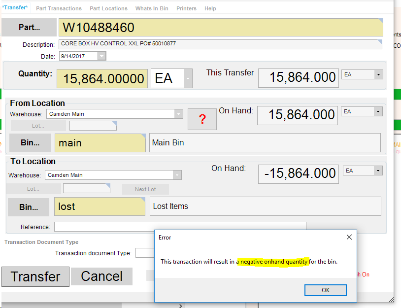

Any thoughts on this transfer issue?
Can anyone explain the logic of this error message. You can see by the data that this should all zero out.
Even trying to ADJUST the qty it gives me this neg error.
I’;ve run refresh onhand from parttran against the part.
Check for allocations in Part Tracker on this Part & Bin.
Have your ran the Recalc Part Onhand & Allocations?
The only other time I have seen this error pop up when the qty’s are fine is when there is an allocation or some other ‘firm’ demand on the Part/Bin. One time there was a pending Material Queue for the Part & Bin. Never found out if it was a bug or not.
(You do know that you could temporarily disable the error, by changing the part’s Part Class Negative Action to Warning)
-Rick
www.getaligned.solutions
They are picked. But I cant unpick because it says they are packed. How do I unpack? I have messed with NOTHING in shipping yet
NM. I found void pack - not sure what the easy way to figure out what pack you are looking for but luckily there were only 4. Unpacked, unpicked, and corrected. Thanks
