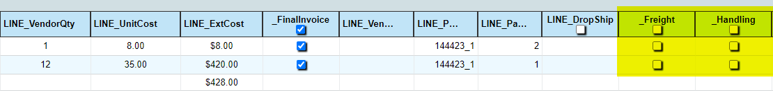

For tax purposes, we have some checkboxes that distinguish whether a charge on an invoice is for freight or handling and then the invoice will show properly on reports down the line. I created variables and put them in the Line Field Group. They show up on the Lines grid and I can check a box, but the value never gets transferred to Epicor (always false). In both the Pre-Create and Create Invoice datalinks, I use these parameters:
Here is where we can check the box

As far as capturing what comes out of Epicor, I have tried doing some recording before with just using the same variable and it will input as true, but then the output is false. The screenshots below are from the Create Invoice step as we likely won’t check the boxes until after the Pre-Create step.

So, did some testing with the Create Invoice step and am getting the same result. Despite the input showing as True, the output always ends up as False. Even tried throwing a temp field that was not part of a field group in there and am just seeing False when I look at the recording.
In your outputs, try using local variables such as zLine_Shipping and zLine_Handling to see if they populate with the “True” value. These can then be used to set the field groups, as Scott suggested above.
In the pictures above, I used zLineFreight in one of the outputs. Was I correct in using it as just a field? Sorry, still kind of new to ECM so not sure if I’m doing things the typical way.
Based on the screenshot I see, it appears that you have created a Field, which is a global variable. You’ll want to test with a local variable.
