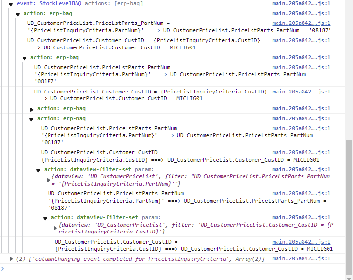

@hmwillett I have managed to stop the Server Errors by splitting the two filters into 2 Dataview-Filter-Set tasks.
I have viewed the dev tools and it seems to be filtering as i want but i still get no returned column in my text box. (for some reason i cannot see any of the Loaded DataViews through the dev tools though)

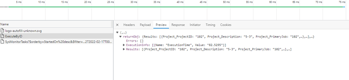

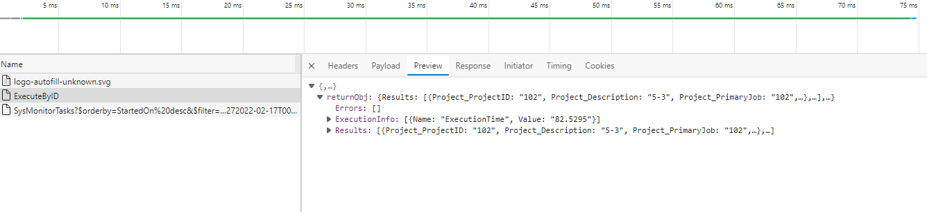

In DevTools on the Network tab, do you see an Execute BAQ call and does it show your full dataset?
@hmwillett I have checked the Network tab.
Looks like that BAQ is failing to load which would explain a few things.

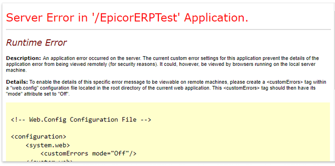

Turn on the remote errors in the web.config file and see what it says.
