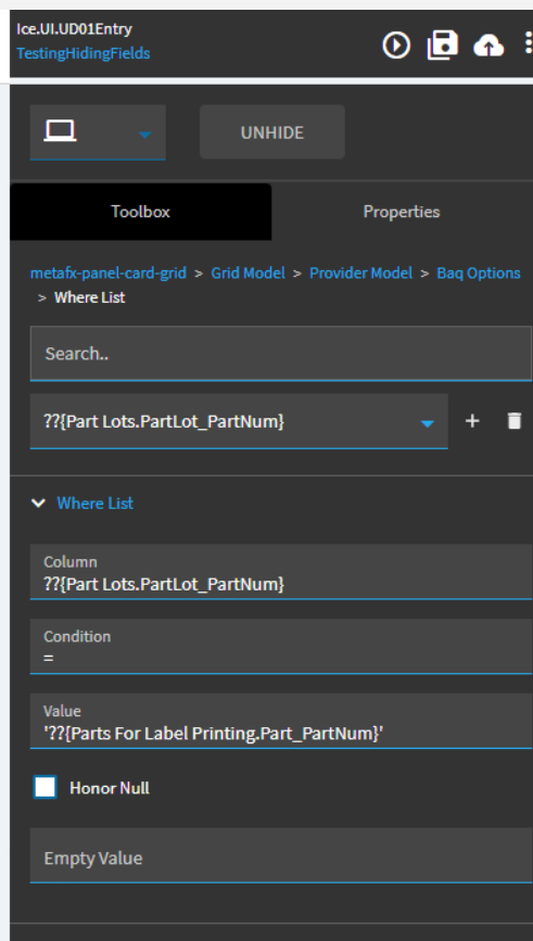

If I set the following under Grid Model → Provider Model ->BAQ Options → Where list I get all the lots even lots that are linked to parts not in the first list
Column: PartLot_PartNum. I’ve also tried Part Lots.PartLot_PartNum and ??{Part Lots.PartLot_PartNum)
Condition: =
Value: ??{Parts For Label Printing.Part_PartNum},
I’ve also tried without the ??
I just get all results. No errors.
The first few results are not parts from the first BAQ, its just the entire second dataview unfiltered
I put it in a static filter on the dataview and get the first part in the first dataview but then if I click another line it doesn’t change so that is not the answer either.

This isn’t right. You shouldn’t have spaces in a dataview name.
Okay, while this does work, this is bad practice and bound to get you in trouble at some point.
This needs single quotes around it all.
'??{Parts For Label Printing.Part_PartNum}'
Didn’t work. It just pulls everything.
Now if I put quotes around the column parameter nothing shows up.
The filter itself doesnt seem to matter, I can type anything in there and it just pulls everything.
If it was wrong shouldn’t it blow up?
Your column should be PartLot_PartNum only.
Thanks but that did not pan out either. I just get all the records. It does not do anything with the filter. At least if it errored I’d know that something is wrong.
Now if I set the where filter one level up in the BAQ options I get no records. So it literally is all or nothing.
