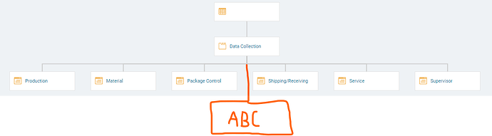

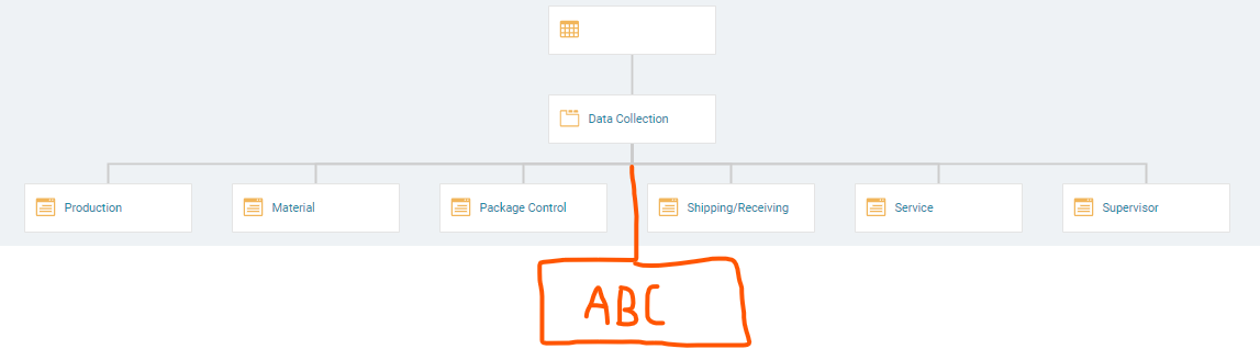

Basically, what I’m trying to achieve is to add another tab to the MES Screen (which is easy to do):

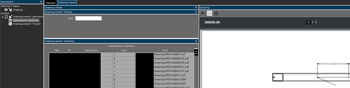

Where I have a grid that is being populated by a dashboard (preferrably), as I would like to make use of Epicor dashboard’s “URL/XSLT View” within the grid.
In the classic view, the dashboard looks something like this:
Alternatively I could just load the BAQ into the grid and then have some viewer (that I’m not sure exists yet) to display the corresponding file from the BAQ row column when clicked.
