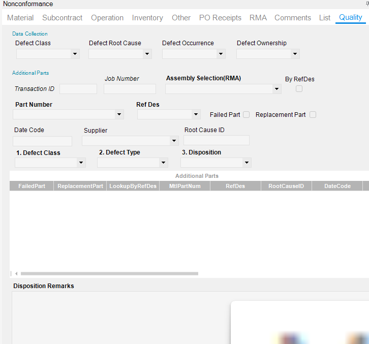

Hello, I am fairly new to Epicor and am focused on upgrading our classic customizations to Kinetic. In classic, we have a custom page, and in the provided screenshot, it shows we have a custom table that can have data entered into it that directly relates and updates the parameters above it. The whole page seems to be using UD08 Keys and ShortChars, and I am having a rough time just getting a grasp of implementing this table along with connecting it to UD08 and above parameters in Application Studio. Would anyone have an idea of where to start to implement this panel card grid to be editable / input-able data to be saved or just any tips in general?
You’ll need to add UD08 as a DataView in App Studio.
Then you can bind controls/fields to the new DataView.
For updating UD08 I’d go with a function and you’ll need Event(s) in App Studio to call the function.
