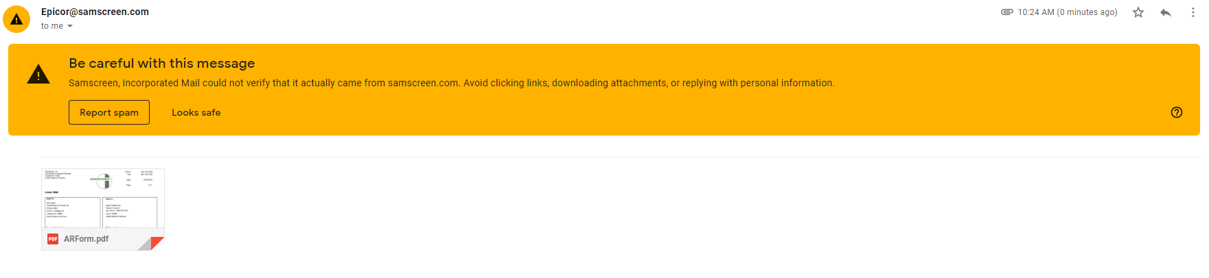

Emails sent from Epicor via APR have a big yellow warning banner, which our customers find alarming. How are other people dealing with this?
I have heard of people setting up that banner for external emails when they come in, but I didn’t think Epicor would do that. What is the banner saying? Or is it just a yellow line?

Do you add the public IP addresses to your SPF records on the domain? My understanding is that if GMail sees someone impersonating your domain this warning will be displayed.

I agree with Brad and Joe here. This is a configuration that Sam Screen has to do with their DNS. If you tell DNS that sendgrid.com (which is the preferred email sender of Azure and I’m pretty sure it’s the one that Epicor is using) can send mail on SamScreen.com’s behalf, I believe this error goes away.
Only thing to be careful of is that by adding send grid to your SPF record, you are allowing anything from them to send on your domain’s behalf. That is how @jdewitt6029 is explaining it to me.
