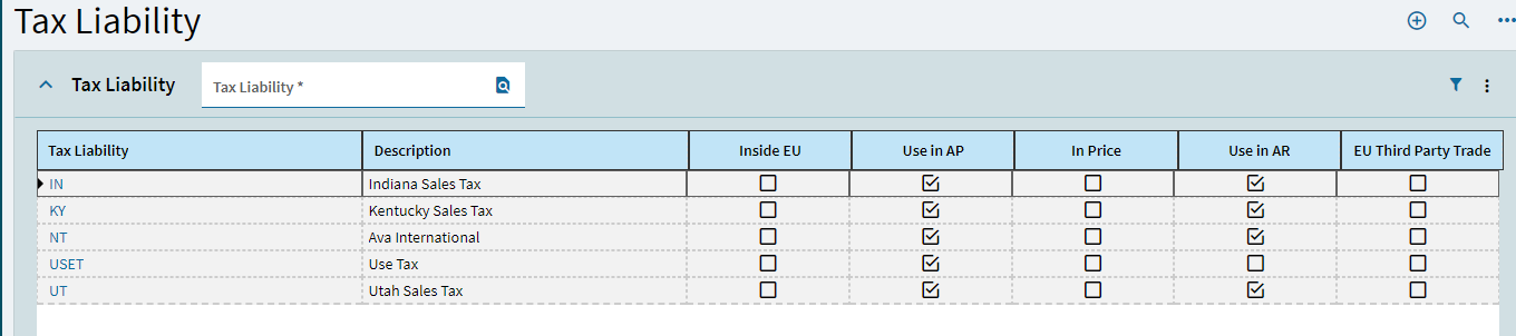

We’re integrating Avalara and have run into a snag. In AR Invoice Entry we need to be able to change the Tax Liability, but it’s greyed out. We have entered an Avalara and Epicare ticket, we all know how long that takes. Does anyone know if this is by design or you should be able to edit it?
Do you have any Tax Liabilities set up that are for Use in AR? If not, then I would expect it to be greyed out.
Avalara handles the tax liabilities so you shouldn’t need to use it at all. What are you trying to accomplish by changing the Tax Liability?
We have tax liabilities set up for AR.
We were trying to change a tax liability in the AR invoice that was blank and should be set as International. The Avalara guy said we should be able to edit it there.

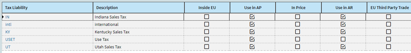

here is the right screen shot, sorry I was in pilot.
Sorry, I got nothing. I just tried a couple of different things and I can’t get mine to be greyed out. I even removed all of the tax liabilities from Use in AR and it still wasn’t greyed out.
