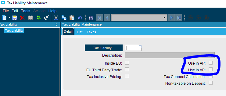

In tax liability you can indicate where to use
If you have a Tax Liability code for AP invoicing just make sure that Tax Connect Calculation is NOT checked. For AR you would never use a Tax Liability code anyway so that will solve the issue.
I was able to do this in our CA company as we are not using Avalara for Canadian Taxes.
This isn’t available in the US company, because we are using Avalara.

Can you use a tax liability code that is set up as non taxable?
That’s the most common solution I’ve seen for this… I believe there is also a setting in Company Config that deals with this too but I’m on mobile and forget exactly what that was…
