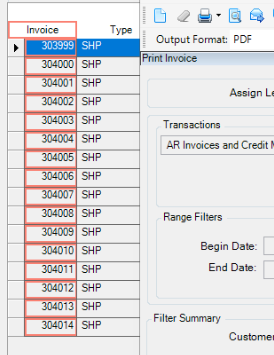

Thanks for the info Bryan. We’re using the Actions > Group > Print invoices within AR Entry. There doesn’t seem to be a filter for that screen (unlike others e.g. MRP, PO Sugg etc). I would assume that Epicor should use the list on the screen to print the invoices
Try what @bderuvo said. When you print a batch, it builds a list of invoices in that group. But it seems to add those to the “saved” list that is created using the Save Defaults.
Try the following as a test
Use invoice tracker to pull up an old invoice
Print that invoice from within the invc tracker. Before closing the print form, use Save Defaults.
In your AR group, use the Group → Print Invoices.
The invoice from the tracker will probably show up in the group’s invoices printed.
