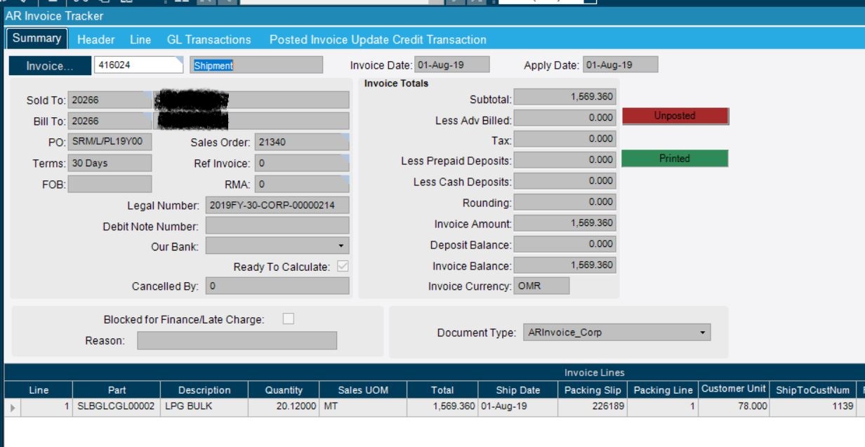

AR Invoice Stuck With Posting Status

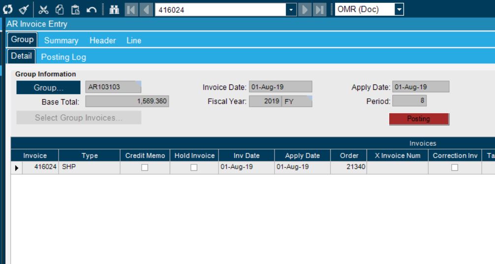

After posting the invoice, Still visible in Invoice Entry form with status “Posting”. But in Invoice Tracker it is showing “Unposted” & Posting Log is blank.
Please suggest me how to resolve this issue?

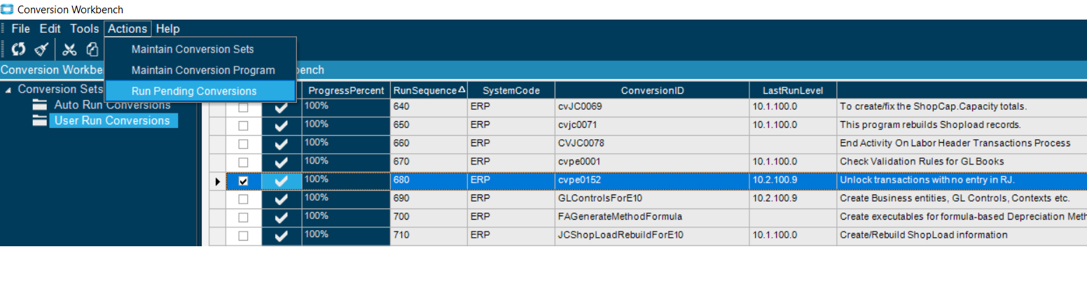

Please following the below steps
  1. Close the Group.
  2. Go to System Management -> Conversion Workbench
  3. Select “User Run Conversions”
  4. 680 – Unlock transactions with no entry in RJ.
  5. Go to Action -> Run Pending Conversion
  6. Reopen Group (will return to “not posted” status) and post again.
