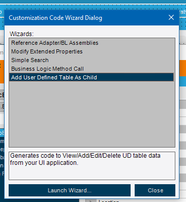

So for UD Tables you have two easier choices, 1 Bring in UD table as a Child this gives you full CRUD into the UD table.
Or you can use a BAQDataview (read only)
In your case since you want to manipulate it you should go with UD Table as a child.

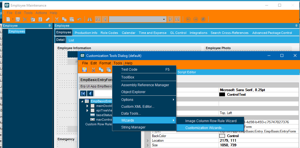

There’s a customization wizard that helps you do that. (not the FKV menu)

That little wizard is quite nice and super powerful it generates something like 11 thousand lines of code all of which you can manipulate slightly to accomplish some quite awesome EpiMagic.

Yeah… there are a couple of tweaks you’ll need to do. But it gives you a way to put a dataview in there.

The wizard does work you jsur have to remove the extra keys from the where clause is not that bad
Not completely, in the wizard I mapped EmpBasic.EmpID to UD10.Key2, and the wizard
generated code for UD10.Key1 mapped instead.
Hmm I stink you where drunk (or maybe they broke something) the mapping generally works though Epicor assumes other keys will also be mapped
