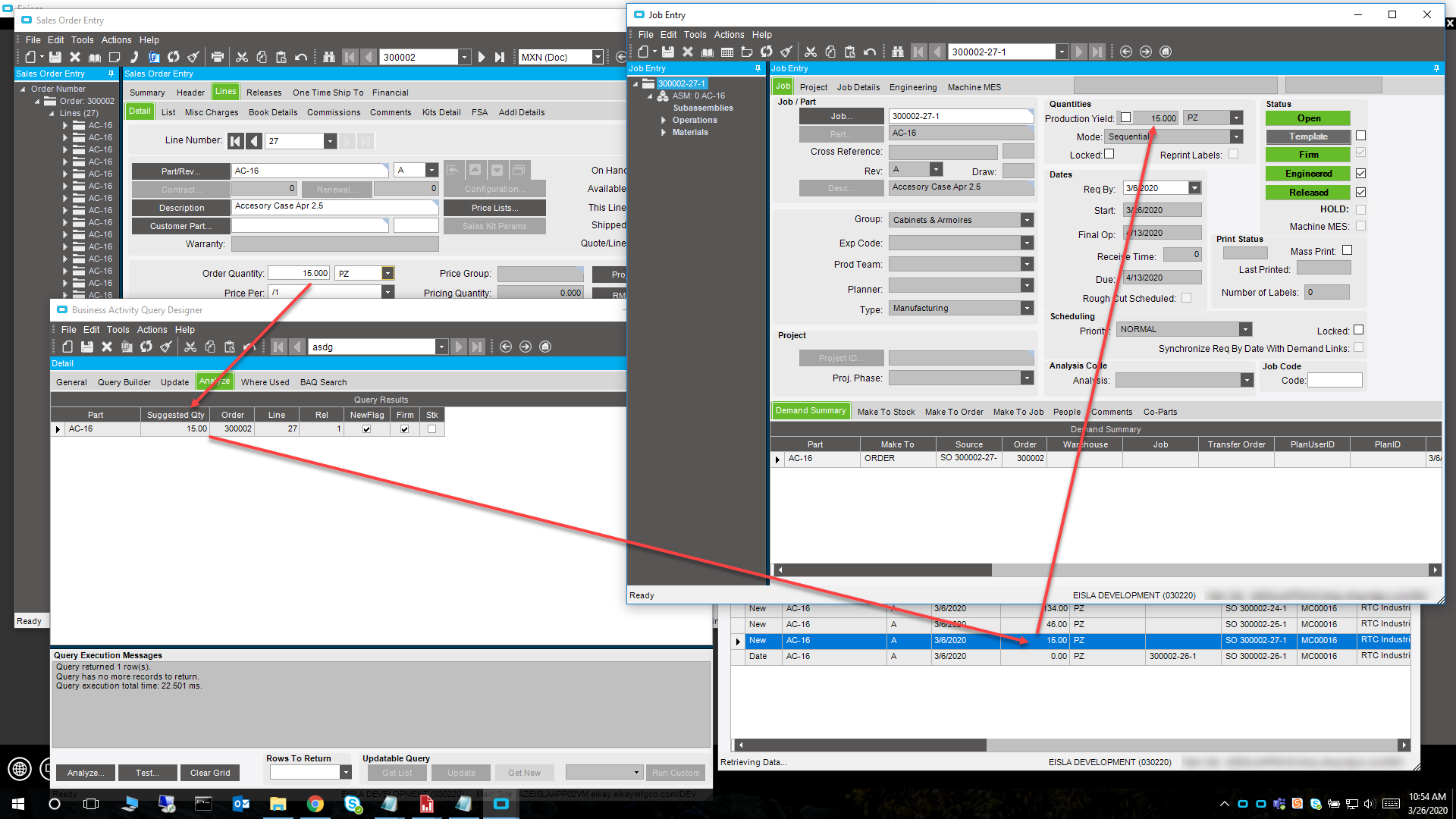

However, for those releases, the Planning Workbench is suggesting a new job for double the line quantity. If you uncheck “Make”, save, then recheck it, the suggestions fix themselves. If I disable the BPM, the suggestions are fine.

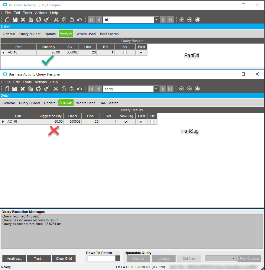

The quantity in PartDtl looks fine, but PartSug is still double.
Would it totally botch things if I just set the proper suggested quantity in the PartSug table?
*Edit: Tried just forcing the PartSug value. Doesn’t want to change.

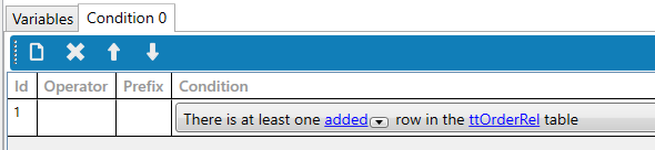

Condition 0:

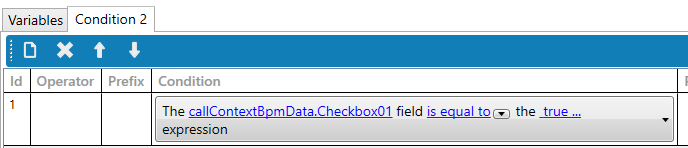

Condition 2:

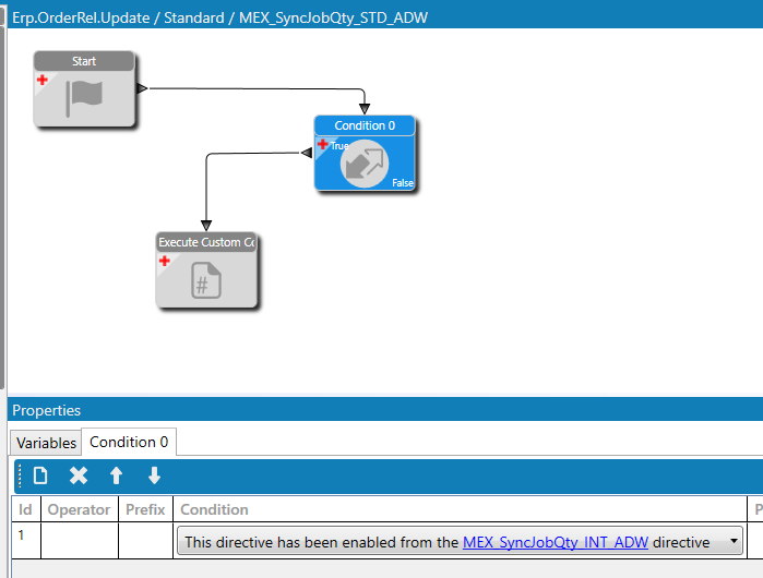

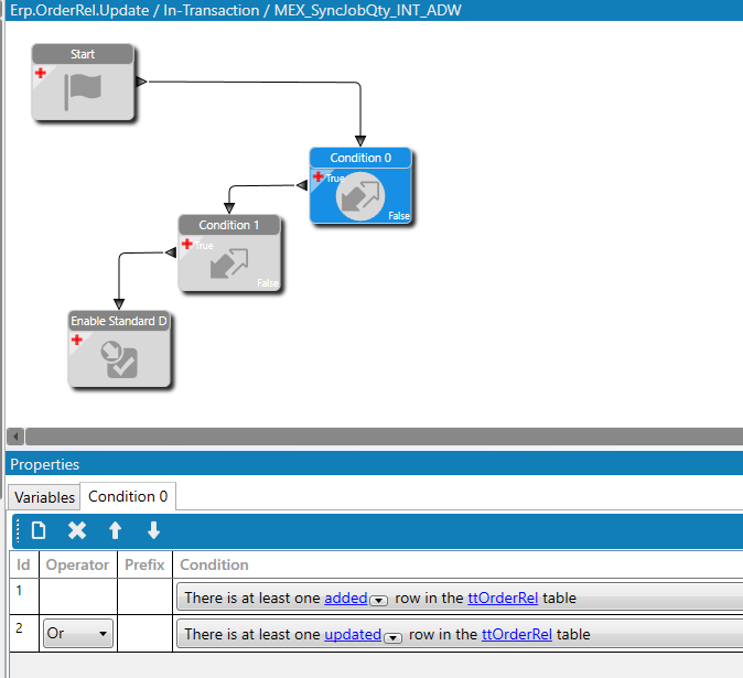

Ah, the BPM wasn’t named anything with “Make” so got confused. Here are the In-Trans and Standard ones. You may be able to skip the code in the In-Trans one but this is how it is in our LIVE so I’m posting it as is.

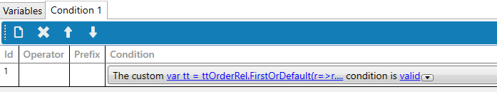

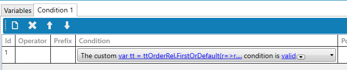

Condition 1:
var tt = ttOrderRel.FirstOrDefault(r=>r.Added() || r.Updated());

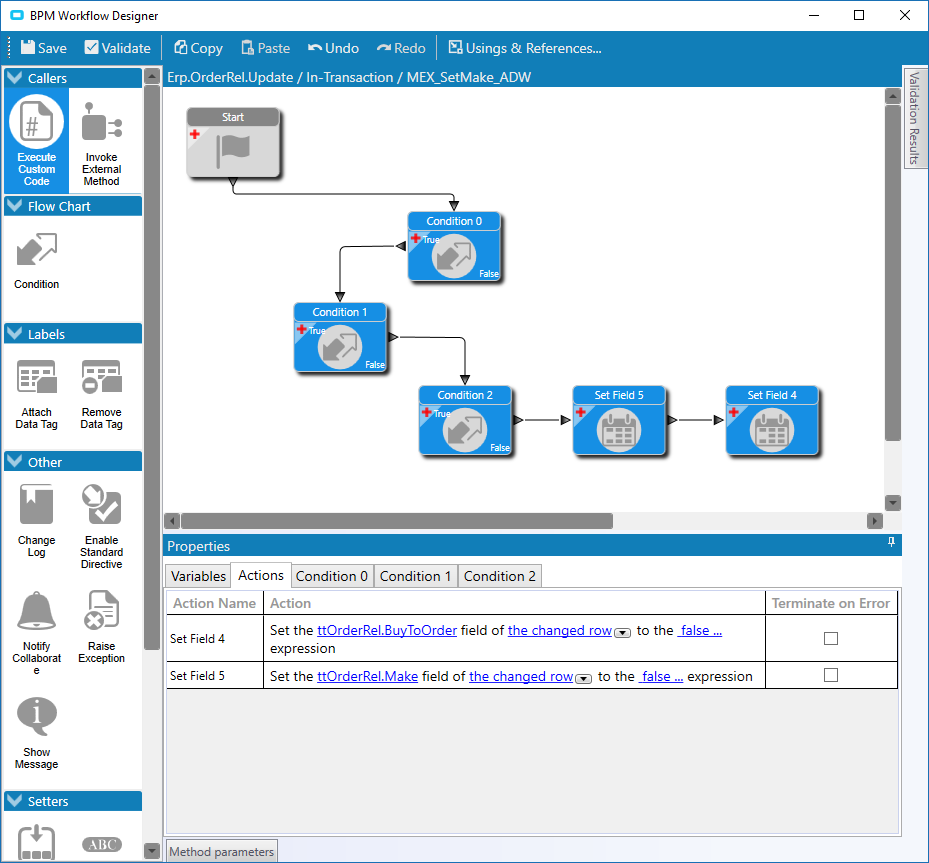

I did get this to work…I ended up only using the In-Transaction directive. I used the Condition 0 from the Standard Directive in this post, then we always want the "Make Direct’ set on our Order Release Lines so I used a “Set Field” and then an “Execute Custom Code” using the code from the Standard Directive in this post. Still need to have our users test but the testing I did it works great.
