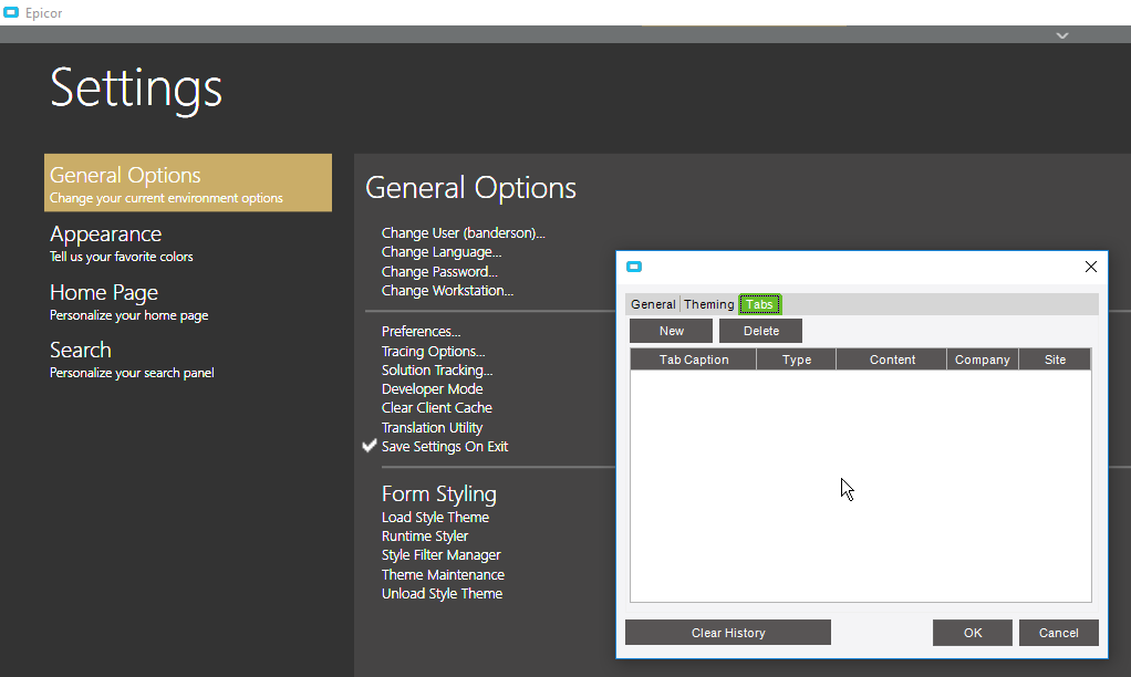

Remove the auto load dashboards (Settings > Prefs > Tabs), then re-add them on same screen using New

He’s not talking about tabs in a dashboard. This is how you get things to auto load. (I have no idea why they call this tabs)
