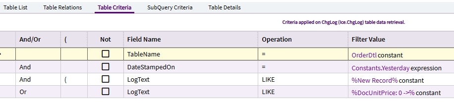

I created a ChangeLog on OrderDtl to capture the fields I wanted to monitor.
I then created a BAQ which queried the ChgLog table.
Here were my table criteria:
So, I only wanted to return ChgLog rows related to OrderDtl…
… which were DateStampedOn Constants.Yesterday…
… which had log text which included “New Record” (to capture NEW sales Orders)…
OR… log text which included changes to DocUnitPrice from $0 to… anything else.
