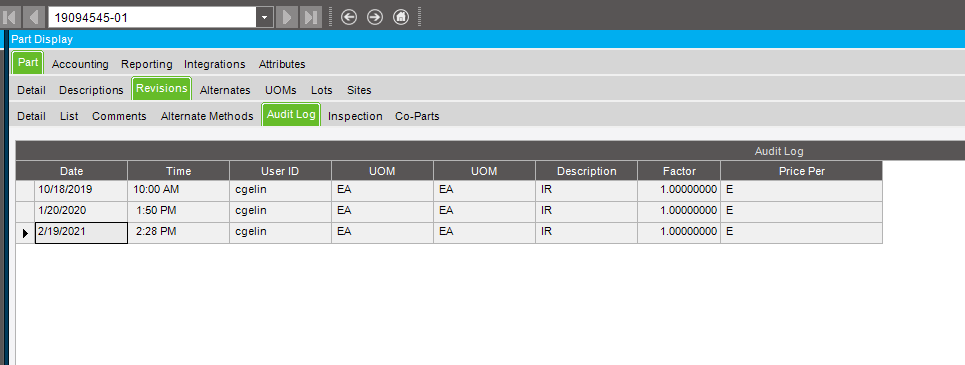

My question should actually be: how do I enable Change Log tracking on specific fields in Part Rev? I don’t see a way to do it. The Audit Log built into Engineering Workbench does not show which values changed, only that there was a change:

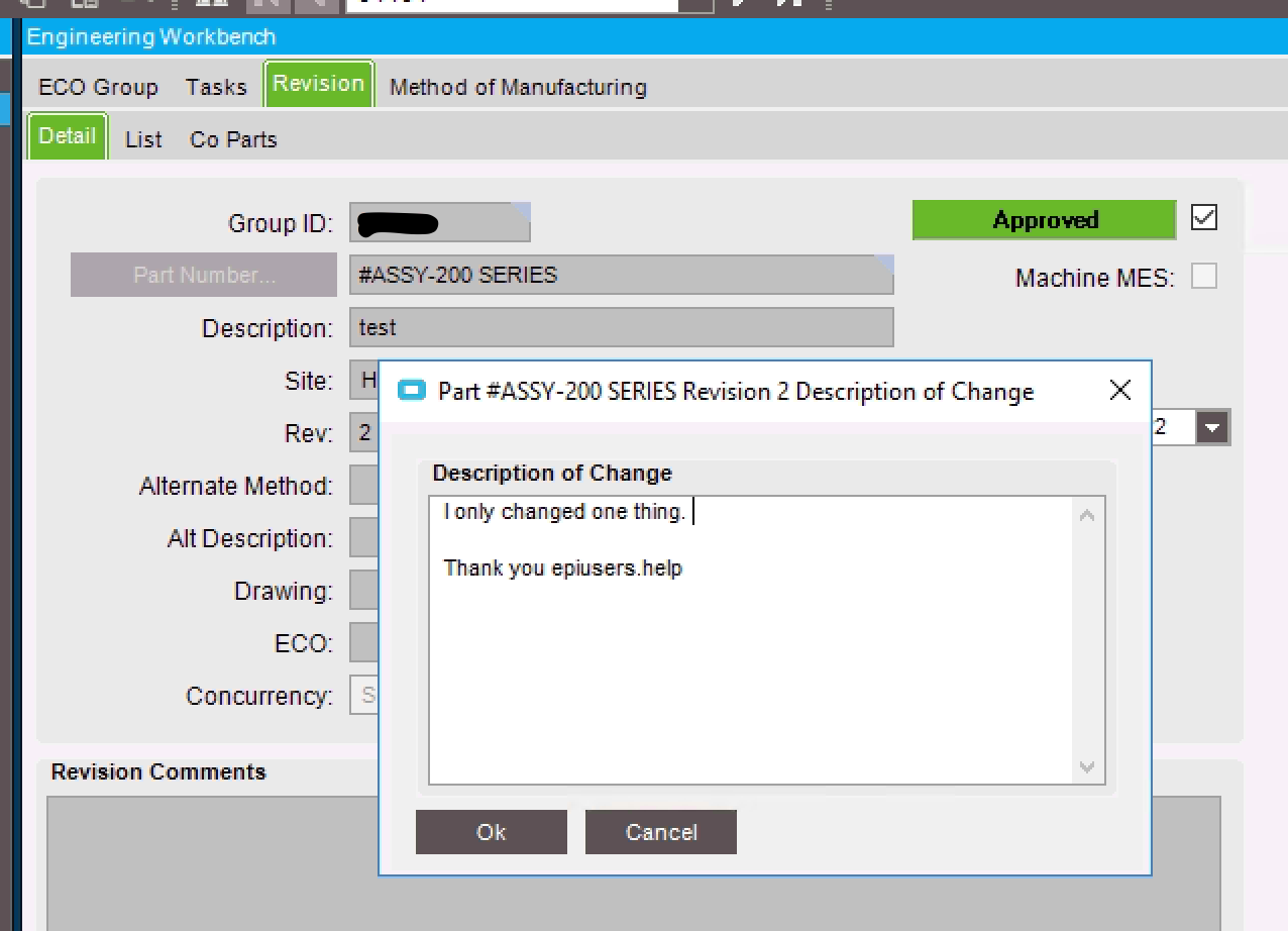

EDIT: this is the screen I am referring to when checking in a new Rev. It asks for change info but is dependent on the user to enter stuff:
You will need to enable change logs on each table that contains the fields you want to track.
For example, if I want to track changes to the Operation.DaysOut field (subcontract lead time), I will need to create a Data Directive on PartOpr, add a Change Log widget, and select the DaysOut field to track.
The main tables that part methods are stored in are:
  • PartRev
  • PartMtl
  • PartOpr
  • PartOpDtl

You’re correct here. This is not a change log. Epicor requires you to fill in that prompt any time you approve a revision.
