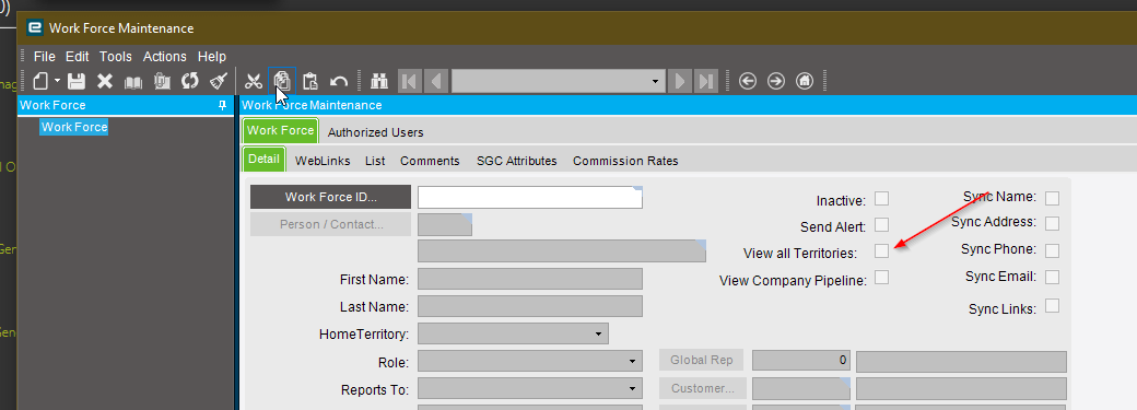

No this really seems like a territory access issue. Can you try going to a workforce record (or create a new one) in that Company
Mark it as View All Territories

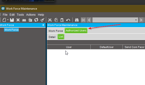

Then make this account authorized on that record
Add Integration Account Here:
That should override any stray territory permissions. If that fixes it, then it means that somewhere… somehow this account got associated with a specific territory.
