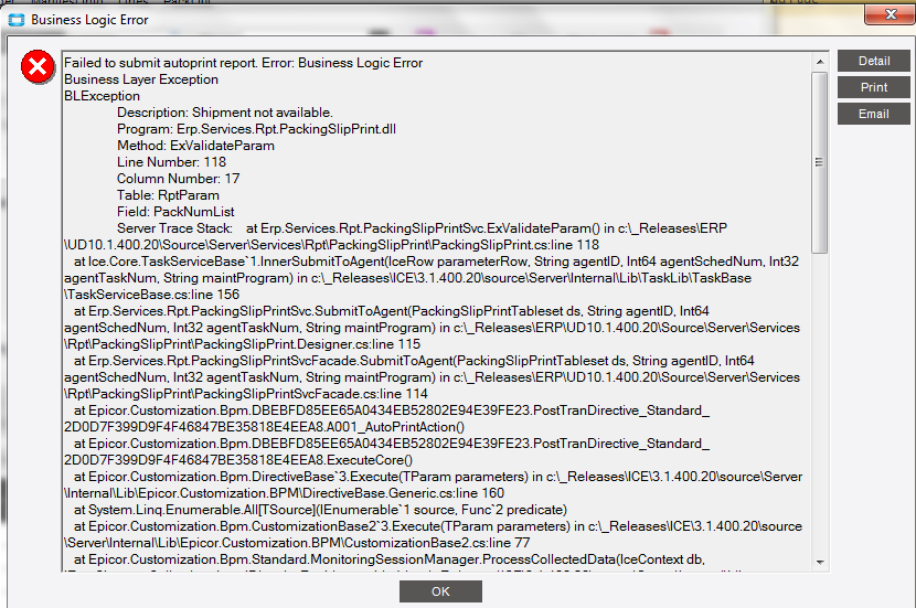

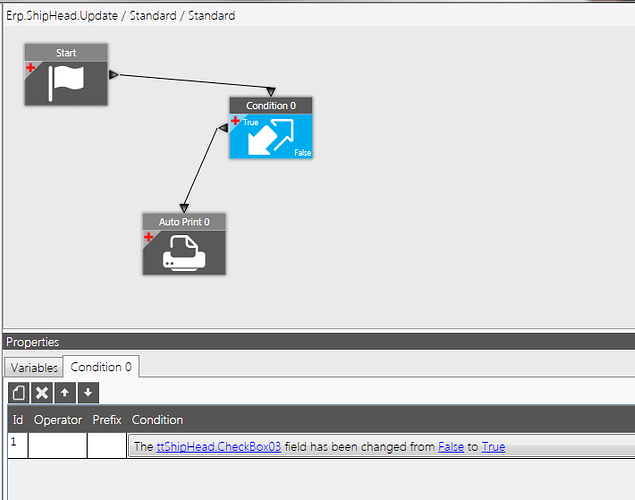

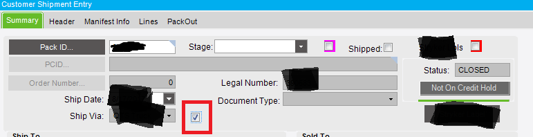

I want to use a BPM to trigger autoprint of a packing slip from shipping screen. I have created my checkbox and set up the data directive, but I keep getting an error that the shipment doesn’t exist. Is this an issue with my EpiBinding? I am binding to a UD field in the ShipHead table and I assumed the data would be available for the report. I have included some visuals below:

What do your report parameters look like in the auto print tab?
