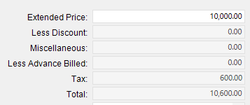

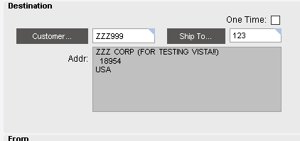

After a quick test, I see that a ShipTo with just a name, zip code, and country, Avalera can do the tax calculation. It still fails an Address Validation, but does calc the tax.
At least on an Order … I don’t have a sandbox setup in Avalera, so I can’t test it on an invoice.
ShipTo Info on Order Release:
And the correct tax is calculated for the Zip code used

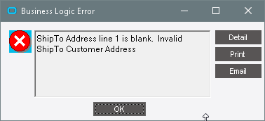

With Address1 blank in the Cust ShipTo, doing an address validation gives you:
Setting Address1 to “GENERAL DELIVERY”, still allows it to calc the tax, but now get a different error when validating addresses:
