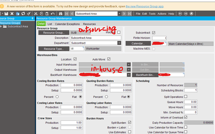

Actually, the reason I asked this question was that the backflush setting of outsourcing production in my Epicor was a little weird. I joined the company after this setting and I was wondering why it was set up like this.
As you can see in the screenshot below, the Outsourcing Production Resource Group’s backflush warehouse/Bin is set to In-house warehouse/Bin. So we’re using “Mass issue to Mfg” to move our inventory.
If I change the backflush warehouse/Bin of this outsourced production resource to that outsourced warehouse/Bin, do I not have to use “Mass issue to Mfg” anymore?
And one more question, we are adjusting the raw materials in Job Entry for various reasons (delete or add other raw materials). In this case, are the materials that are backflushed from the job the adjusted materials of this job or the same material as the BOM?
Thanks in advance!
Subcontract operations don’t backflush material.
You will need to have a standard operation backflush the material or mass issue the material.*
