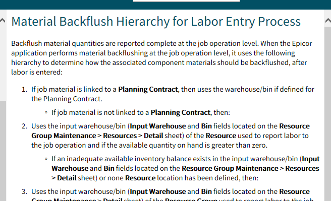

There’s a hierarchy in the help to help you see how you can manipulate it.
Ultimately, you’ll have to find some way to tell it where you are pulling it from. If you have a clear algorithm to determine that, you might be able to make it so someone doesn’t have to tell the system where you got it from, but as soon as you put any “It depends” into it, you’re hosed. At that point, having material handlers issue it to the job when it’s delivered to the work cell is the best way to go.
