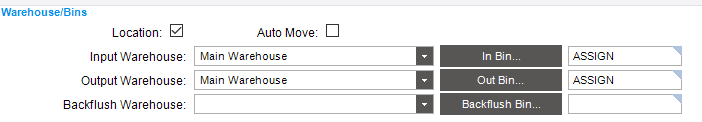

Hello, this is extremely helpful, am I reading this correctly that the only way to have material pull directly from the part’s primary bin location is to ensure that all the input and backflush options are not specified?
