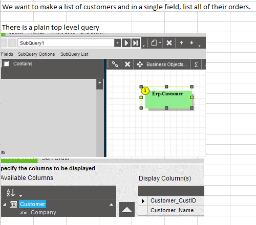

BAQ: Calculated Field Concatenate Rows to single field
I did get it working @edlugoposki and for next time I put a little guide in my cheat notes. As mentioned previously this only works in Epicor 10+

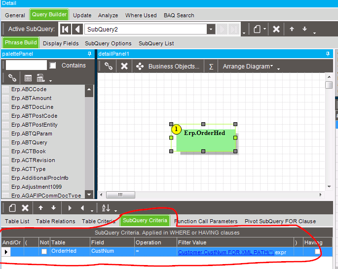

In fact, I don’t know where the WHERE OrderHed.CustNum = Customer.CustNum comes from as the desginer shows no links between Subquery 1 and Subquery2
I found it.
Its in the SubQuery Criteria of SubQuery2.

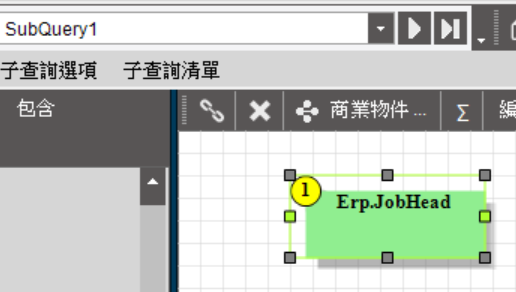

Hi Jose, I download your your example and just change
quert1 customer–>jobhead
REPLACE(REPLACE({SubQuery2} , ‘</Calculated_Pa>’,’’),’<Calculated_Pa>’,’’)
query2 orderhed–>jobmtl
CAST(JobMtl.PartNum AS VARCHAR) + ‘,’
however I can’t get the result, may you help to check where is the problem?
I aml very apprepicate. Thank you.

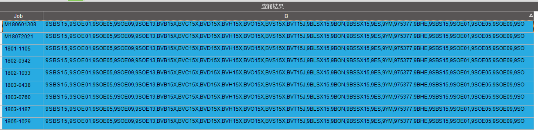

Only 19 material, but it shows over the 100 material
the result show 13 row jobnum and each row should be only with 19 material. how ever it shows 13*19 material with each row.

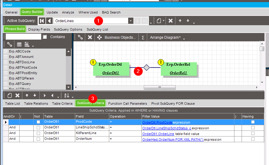

Mine has an inner sub query (1 in the pict below)for the special case
(2) You’ll need to join the tables
(3) The SubQuery Criteria might also need other lines (if your trying to select specific records for appending.
The above appends the LineNum for records with matching Product Code AND LineShipStatus_c AND KitParent Line
The result in the Dashboard is to make a field(“Product Group and Lines”) that list the lines of an order that are for the same ProdGrp and ship status (a custom field) and Parent Kit (just to filter out the kit’s components)

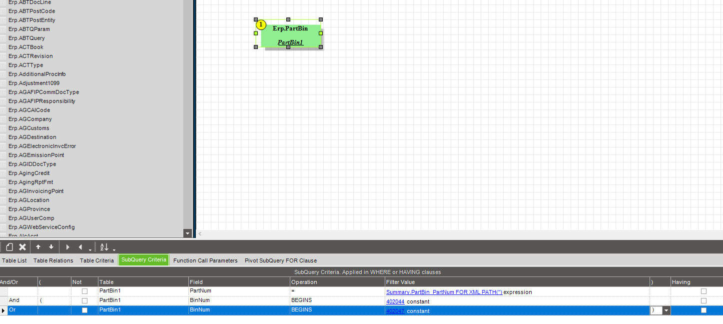

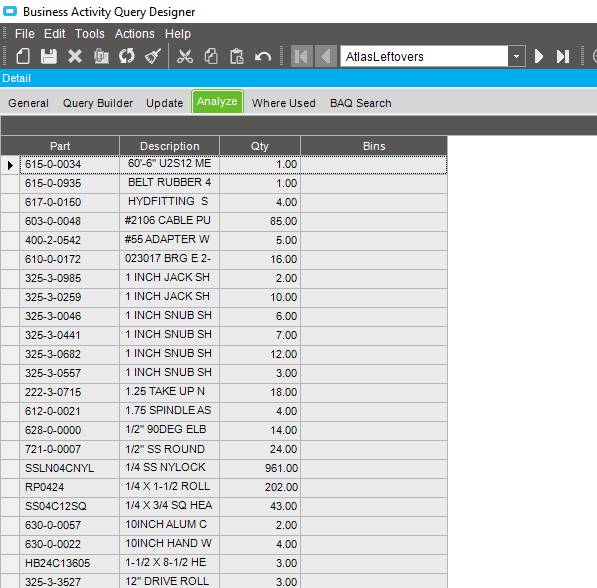

I want to add a table criteria in the subquery that is getting the items to concatenate. If I have no createria on the table (PartBin in this case) it works just fine, other than it has bin numbers that I don’t want. If I add a criteria, it Bombs out. Am I not allowed to add a criteria for what I want returned?
This is criteria I want to add.
Here is the SQL.

Try putting the critteria in the Subquery Criteria tab
I did. still bombs out…

Error?
oh I see yeah the subquery criteria in this instance uses that XML thing… Instead you should be able to add anotehr subquery drag part bin in, filter it, then use that subquery instead of your PartBin1 as the source.
Well, it doesn’t bomb out, but the bin locations come back null. I thought I changed what I needed to, but I must have missed something.
ok in your subquery you were using partbin table (aliased as partBin1)
Add a new Subquery, and Drag PartBin into it and filter it. Then in the above original query delete PartBin1 and drag in your subquery then apply the same XML thing to it.
