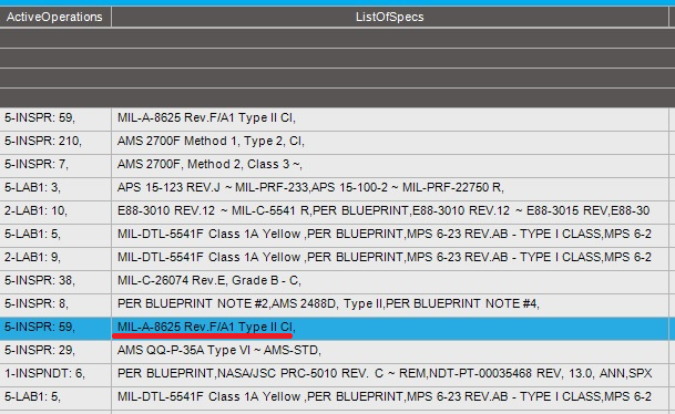

Has anyone experienced a character limitation when using this concept. What I mean is the results of creating a list into a single column, limits each element in the list to 30 characters. I am doing this to a UD field that is set for a string with a format of x(1000). Neither of my calcFields are set for x(30).

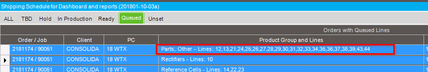

The field “Products Group Lines” sown below is a concatenated one. And that one is over 80 chars

Hi @ckrusen, I think you misunderstood me. I don’t mean the size of the total field, but the size of each element within the list. So between the commas. Here is the results that I am getting.!
Hmmm… Is that from the first line of the Part.PartDescription?

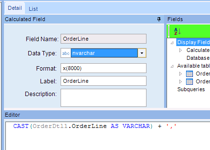

I think you need to look at the calc field that combines the values. Mine is
CAST(OrderDtl1.OrderLine AS VARCHAR) + ','
try changing VARCHAR to VARCHAR(50) (or however long you need it to be)
edit:
That might pad the individual values, so a TRIM might be needed. Maybe:
TRIM(CAST(OrderDtl1.OrderLine AS VARCHAR(100))) + ','
That was it @ckrusen! I can’t believe I didn’t think of that.

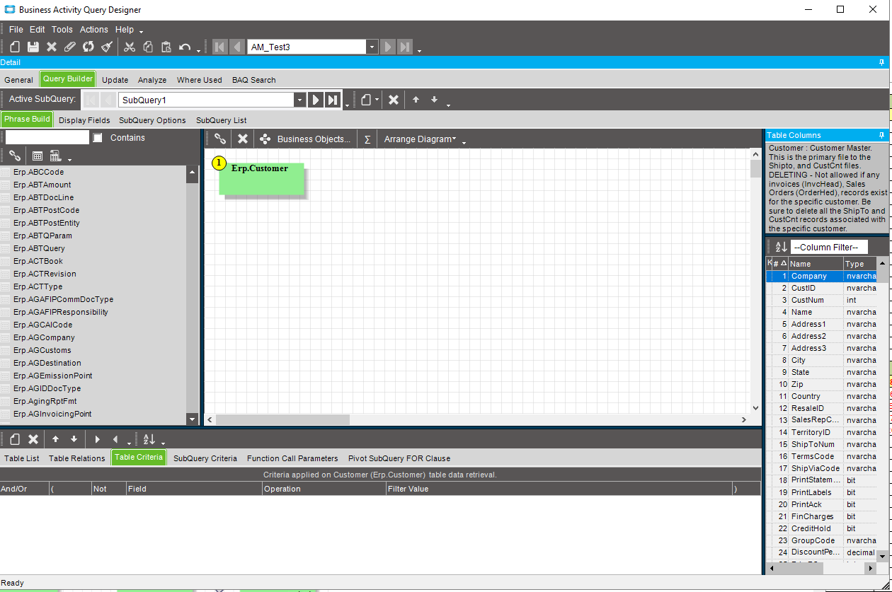

Hi @ckrusen, I followed along exactly like your Order example, but when I try to Analyze results I keep getting error “Severity: Error, Table: , Field: , RowID: , Text: No column name was specified for column 1 of ‘SubQuery2’.”
The fields are all exactly named like your example, so I’m at a loss. I get this error regardless of which tables I try this with, so maybe a bug in 10.0.700?
Can you post the Query Phrase (shown on the General tab)?
Yup! Here you go:

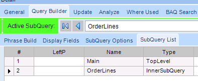

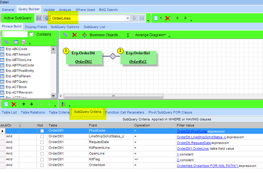

Mine has 2 queries.

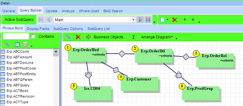

The Top Level one (named “Main”), does not include the other one. The Top only contains tables.
The second sub query (‘OrderLines’) has two tables
Neither has any table criteria

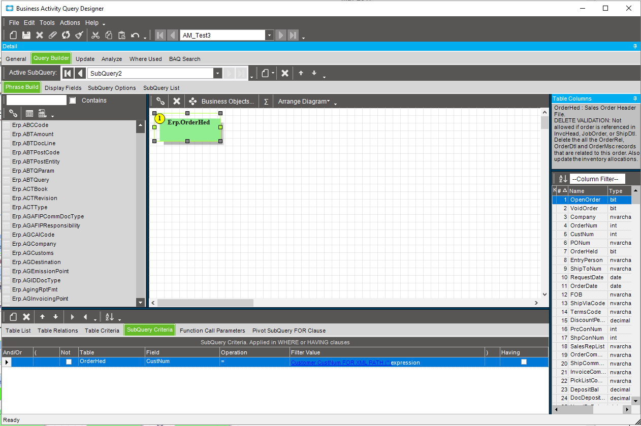

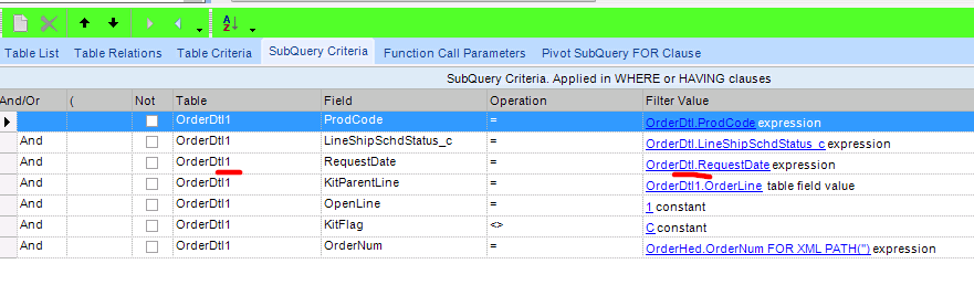

The second query DOES have SubQuery Criteria:

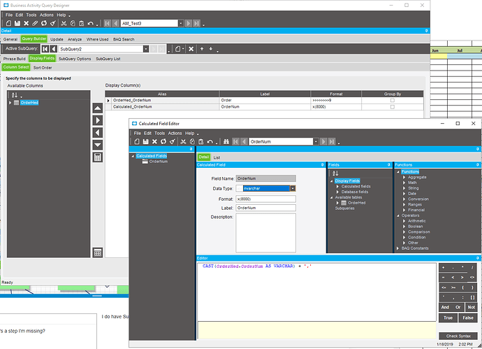

and the following display columns
The expression for that calc field is
Make sure the SubQuery Criteria with the ‘…FOR XML …’ is the last criteria

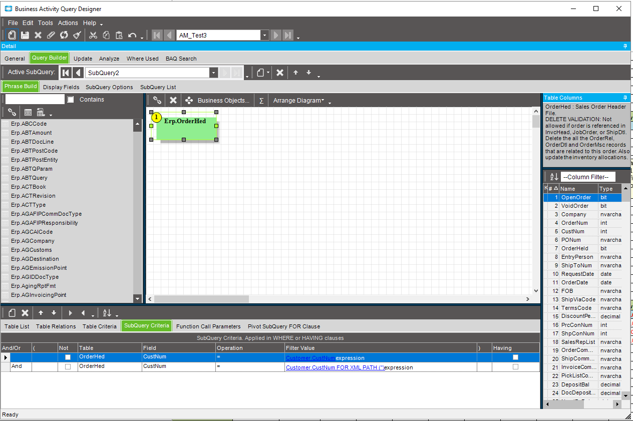

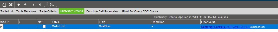

I do have SubQuery 2, but it’s not joined to SubQuery 1, unless there’s a step I’m missing? Screenshots attached.
Try removing the OrderHed_OrderNum column from SubQuery2.
You also need to add to the SubQuery Criteria for SubQuery2. Basically make the “joins” that you would have had if SubQuery2 was being used in SubQuery1
It might not be obvious, but in mine the Table column referes to the table in the second Sub-Query. (because my main subquuery alread has a table OrderDtl, the one inserted into SubQuery2 was named OrderDtl1. )
So I had to add criteria to connect the SubQ2 to the main one. Note that the tables in the expressions of the Filter Value column refere to OrderDtl And not OrderDtl1 (ignore that one line that does. It is to limit the results of the second SQ, and not used for linking to SQ1)
I added that originally to see if the error message would go away. I removed it and still get the error message.
Isn’t that what I’m doing with the SubQuery Criteria for SubQuery2 here?
I’m not 100% positive, but I think that SQ Criteria (with the “… XML…”) just ends up inserting the required code in the Query Phrase to make the conactenation. I think you still need have criteria linking it to SQ1.
In my example, SQ Criteria:
  • Lines 1-3 link it to the main query. I think of it like the join to limit which records SQ2 uses to make that concatenated value.
    *Lines 4-6 limit which records of SQ I’m going to use for the concat.
  • Line 7 is the one that builds the code in the Query Phrase
