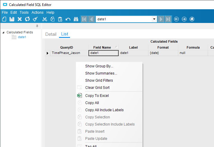

BAQ calculated field - paste insert (is a no-go)
This would be nice, but it’s grayed out. (Yes I have something copied to the clipboard.)
I’m doing a union and 90% of the fields are bogus (null) on the lower query. I sure would love to hammer these in with Excel.
Any other way?
That grid is entirely R/O. And you can’t personalize or customize the BAQ Designer or it’s subforms.
A more daring person might try making a uBAQ on the QuerField table. But there probably aren’t any BO’s that would trigger the update.
Right. I had to ask. I thought maybe there was something simple I was missing. I think this is just part of the drudgery of union queries.
