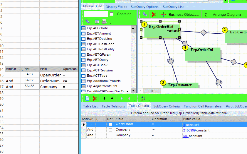

I can copy and Paste Update (not full rows) in the BAQ Table Criteria pane…
Watch how I use Paste Update to change the Field of row 2 from Company to OrderNum
Happens to me on 10.2.300.11. Annoying!
Ah I’ve tried with full rows… I’ll give her a shot thanks @ckrusen
Paste Insert doesn’t work (even with just the first 4 columns worth of data).
But Paste Update does seem to (as long as you’re not including the Filter Value column).
You can add several new (and “undefined”) rows first, and then use Paste Update for the first 5 columns: And/OR, (, Not, Field, and Operation
