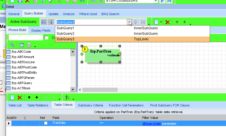

  • SubQuery2 - InnerSubQuery. In my prior post I referred to this as SubQ1. Joins between PartTran_1 (it will have to have a different name as PartTran will first be used in Subquery3) and SubQuery3.
  • SubQuery3 - InnerSubQuery. In my prior post I referred to this as SubQ2. Contains just the PartTran, shoud have a table criteria of TranDate <= @ReportinDate.
Make Subquery 3 first, and set it as the Top Level (this is just to test it, and you’ll need to set SubQuery1 to InnerSubQuery). Then when you run it it should return the Last Transaction <= the provided date. Once this work as expected, set the Query type back to InnerSubQuery.
You should get something like:

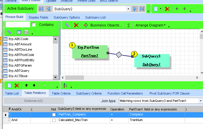

Make SubQuery2 by first adding the PartTran table (it will give it a new name), then SubQuery3. Set the query type of Subquery2 to TopLevel (again just for testing). Make the table relationships (Joins) as:
Have the display fields be:
(You don’t really need the MaxTran field)
Now test this IT WILL TAKE A LONG TIME TO RUN (just like the real SSR). Your output should be one record per part, with the cost used at on the last transaction <= your desired date.
