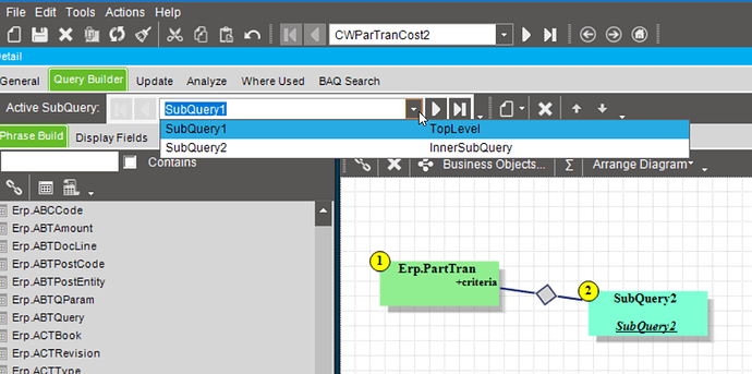

I’m in that circle of hell right now. I get the calculation for the TotCost and group by the part, but then when I try to join it up to my main query that narrows it down to just the MAX Transaction number It doubles… I am sure I will get it eventually!
Picture of your BAQ designer?
(the graphic showing how the tables and subqueries are related)
I have one subquery that does the calculation: (PartTran.MtlUnitCost + PartTran.LbrUnitCost+ PartTran.BurUnitCost+ PartTran.SubUnitCost+ PartTran.MtlBurUnitCost)
I have a second subquery that does: MAX(PartTran.TranNum)
I join them in the main (top) query, but any which way I get multi-part identifier can’t be bound error.
I’d love to just assign a variable to the single result and pass it.
Put the second subquery in the first (the one that adds the cost fields together). The flow being that the subquery that returns the MAX(TranNum) is used to limit the part tran records used to add up that part’s cost. Then the first subquery would be in your top level query.
SubQ2 Returns one record for each part in parttran. Display fields:
  • Company (group by)
  • PartNum (Group By)
  • Calc field MaxTran = MAX(PartTran.TranNum)
SubQ1 Contains PartTran and SubQ2, relating company, part number and Trannum (to MaxTran).
Display fields:
  • Company
  • PartNum
  • Calc Filed DatedCost = MtlUnitCost + … + MtlBurUnitCos
In the top level insert SubQ1 joining Company and partnumber as needed in the top level. SubQ1.Calculated_DatedCost should hold the cost of interest.
I left a lot of details required for you end goal, but this should point you in the right direction.
Thanks so much!! Will try right now!
I must have missed something…
“The multi-part identifier “PartTran.TranNum” could not be bound.”
