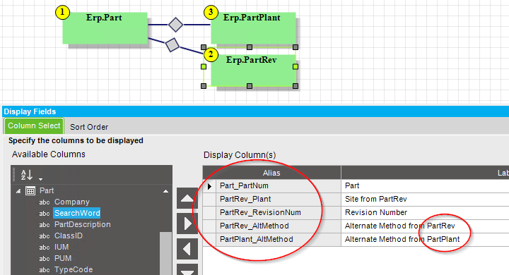

In the above scenario… if rev A is the current effective/approved rev, then it would use alternate Y in plant 2… but in Plant1, it will either use the “primary” (no alternate id) or Alt X, depending on one factor… did you specify to use the alternate method in the PartPlant.AltMethod? If so… then it will use this alternate method as a default.
try creating a BAQ with the following layout and fields, and it might help you understand. You might add a filter for only APPROVED revs so you don’t see tons of repetition.

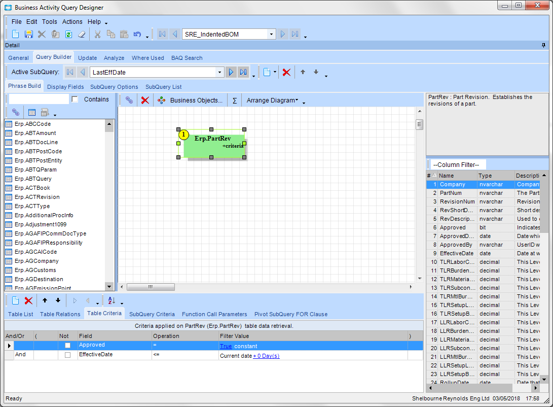

Yes I have got a sub query to calculate the maximum effective date of an approved revision. It then uses this sub query to find the revision for that part. I’m using a CTE and Union query to account for all BOM levels as per the Epicor ICE Tools example but for some reason it seems to stop if the part is a phantom assembly. See BAQ below.
SRE_IndentedBOM.baq (88.3 KB)
It works but for some reason no longer searches below phantom parts.
